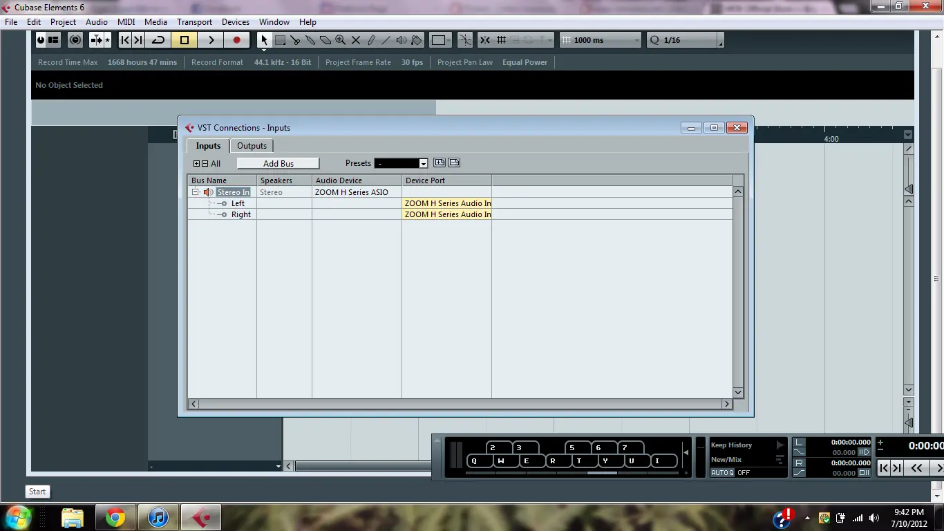

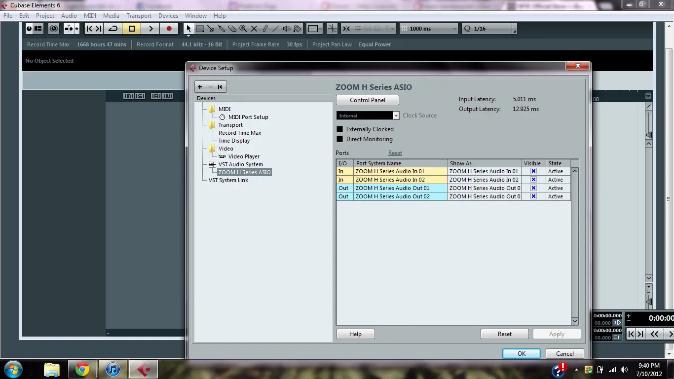

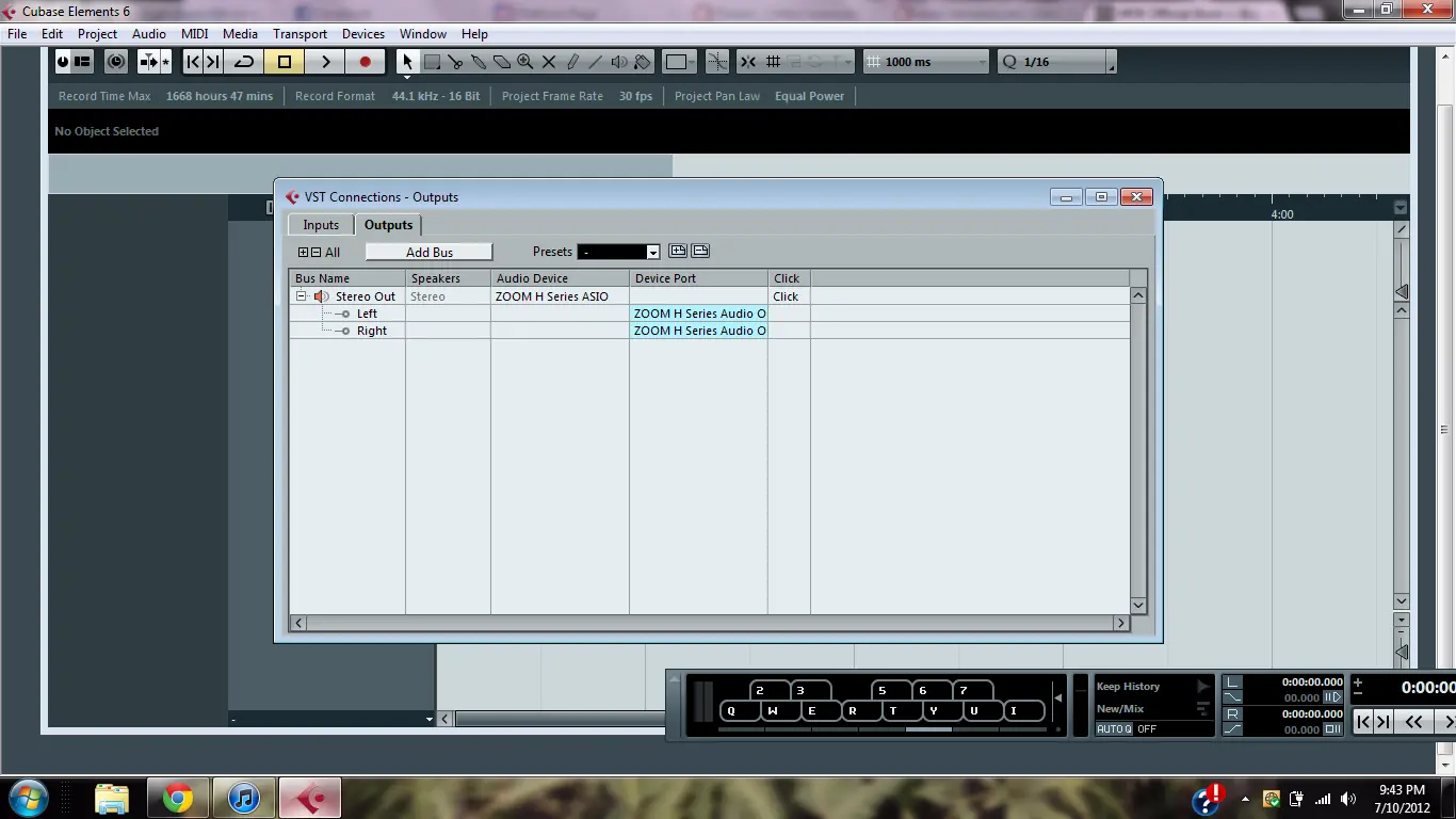

I have the latest drivers, and everything in vst connections says its all connected but i still cant get any sound to go in for recording, Ive restarted cubase and my computer many times to try to get it to work, it worked last week perfectly but now its just crap. I tried tons of things before i posted here so i dont think it is something too obvious but if it is please tell me, and yea thanks for reading this.
please watch this video because it shows everything. I have restarted computer many times, and re-installed the driver 3 times. Here is the video, but i cant post links yet so just type in /watch?v=Vo38-Df4r7w after youtube(dot)com
edit: for those of you who dont want to watch the video here are the pictures, hit record and nothing gets recorded and go on the mixer and when i tap on the mics no sound is going in
EDIT SOLUTION: Hey guys so after I convinced my self I was doing every single thing right and was doing the exact same settings as I was when it did work, I decided to contact Zoom support to see if it is was the zoom by some chance. I found out that the zoom h4n has some compatibility issues with AMD motherboards. So basically I sat there reconnecting and disconnecting my zoom h4n for like 30 minutes and it worked eventually, then did it one more time and it didnt work. So basically theres about a 1 in 20 chance then a certain connection will work. I used my sisters computer with intel motherboard and no problem each time, so yea its just I have an AMD chip and it aint so hot with zoom h4n. Thanks for trying to help me anyway :p

I didn't see the monitor button lit up on the channel. It was too fuzzy to tell if you selected the input bus for the channel in the Inspector window either. Check those first.

Yea i had the input bus selected. I have no applications running, my computer is relatively good, its pretty new, like 2 months old, i know its not going to be able to handle any massive projects but yea like i said before i was able to record a song last week with applications running at the same time and it ran perfectly smooth. The h4n is an input device and also an output setting, I didnt have the moniter button clicked but it doesnt matter because when i clicked record there was nothing being recorded anyway, right? hopefully thats not a retarded thought haha. Im not really a computer techy or anything so i dont know how to say what im running haha, but here is the computer i am using: the hp dv6z-7000 series and i upgraded to AMD Quad-Core A10-4600M Accelerated Processor (3.2GHz/2.3GHz, 4MB L2 Cache) and 640GB 5400RPM Hard Drive and 12GB DDR3 System Memory (2 Dimm). Thanks for helping, and sorry for the bad video quality i didnt want to do 1080 cuz the file is just too big
idk if this helps any troubleshooting or anything, but if i have cubase already running and then plug in interface it runs smoothly but still cant record anything, but if i have interface plugged in prior to opening cubase it runs slowly and still cant record anything, but i think ive read many place that plugging in everything before opening cubase is the right way so idk if that helps or anything
Hey guys so after I convinced my self I was doing every single thing right and was doing the exact same settings as I was when it did work, I decided to contact Zoom support to see if it is was the zoom by some chance. I found out that the Zoom H4n has some compatibility issues with AMD motherboards. So basically I sat there reconnecting and disconnecting my Zoom H4n for like 30 minutes and it worked eventually, then did it one more time and it didnt work. So basically theres about a 1 in 20 chance then a certain connection will work. I used my sisters computer with intel motherboard and no problem each time, so yea its just I have an AMD chip and it aint so hot with Zoom H4n. Thanks for trying to help me anyway
