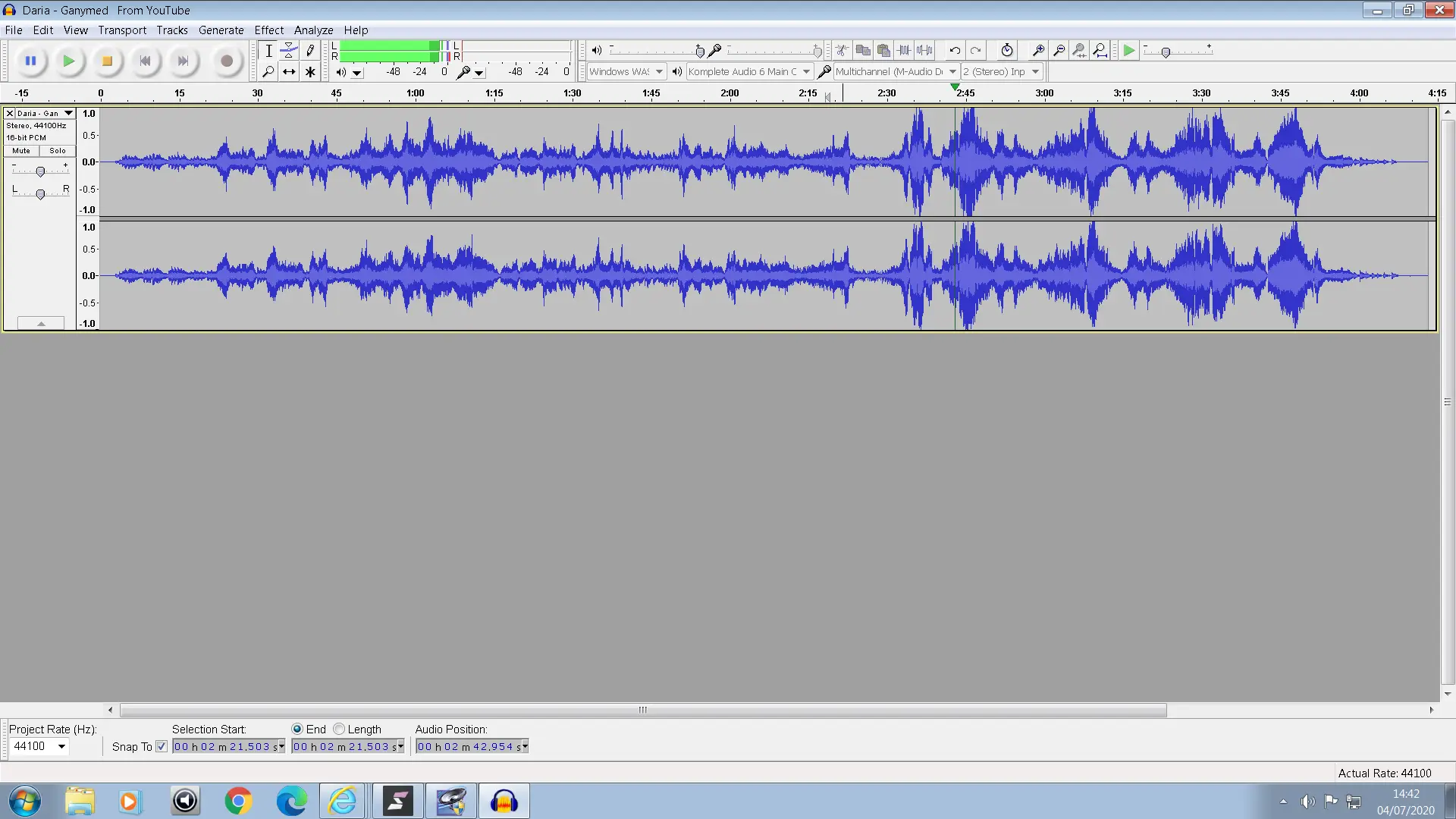

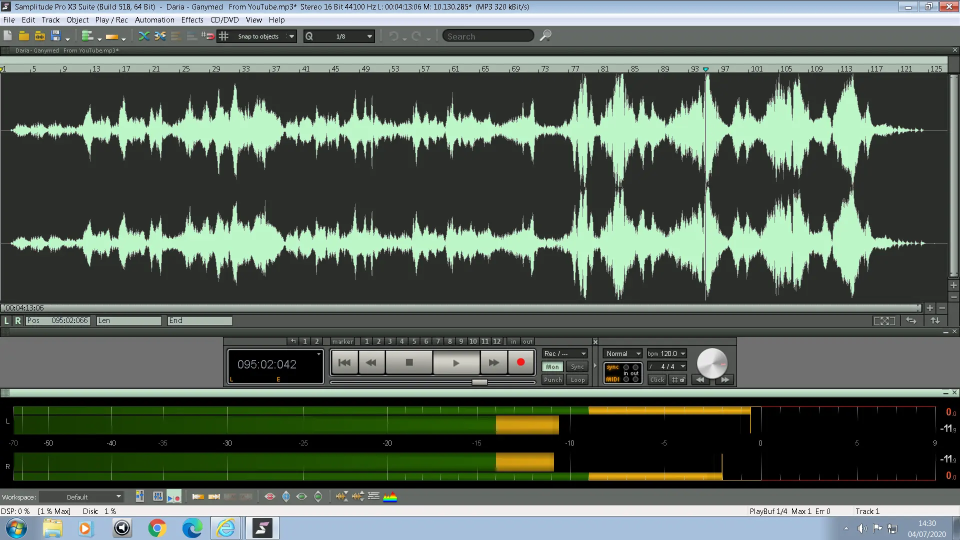

I dropped your MP3 into Samplitude ProX 3 Rich and found much the same result as before.
This time I used my 'studio' desktop ( Asus, 6 core 3g AMD) and the onboard sound card was disabled and all the audio ran through my KA6 with ASIO drivers. I always have all effects off on all my machines.
The screenshots show the level still hits 0dBfs (didn't quite catch Prntsc in Sam) both in Samplitude and Audacity. Not shown but Adobe Audition 1.5 does the same.
There is also the same drop in level in mono and the piano tone changes.

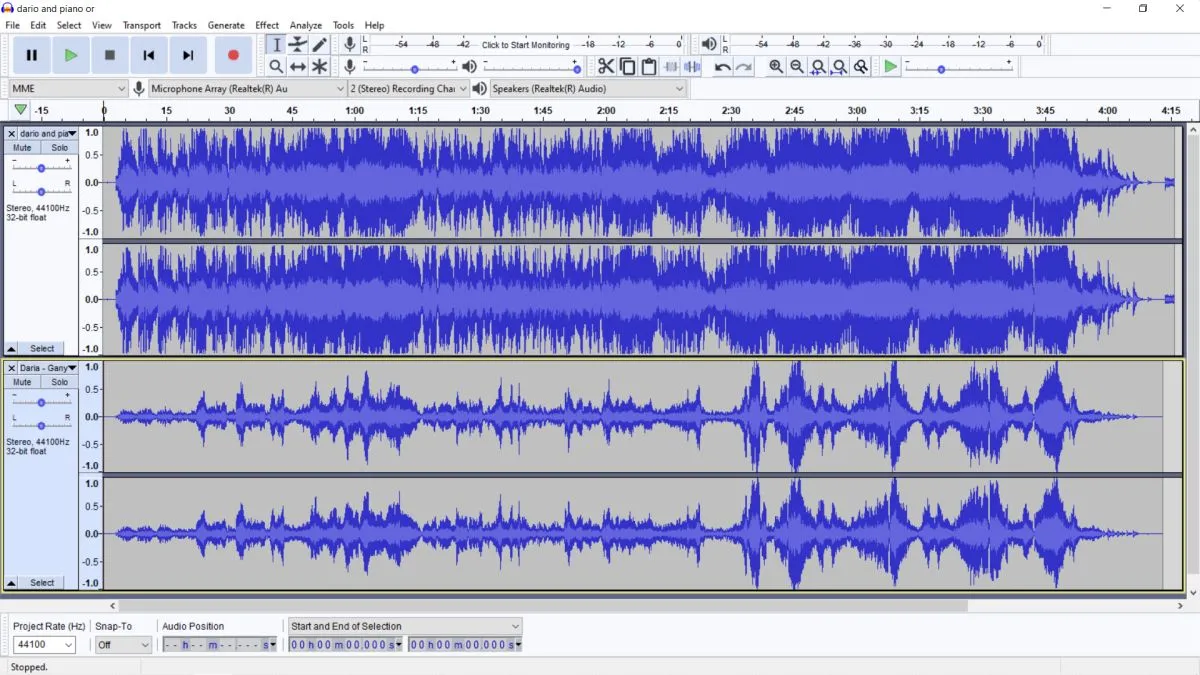

I agree that the my extracted file hits almost to 0dBFS. Reaper reported the peak at -0.7dB. However that's only a couple of places. Most of it was well below that.
The file Daria and Piano OR.mp3 that you posted looks very compressed by comparison. Is that the correct file? I threw both into Audacity. Your file is on top, mine on the bottom. The bottom looks like what you have in the pic above.
Audibly, the top file sounds VERY compressed, The piano sounds almost as loud at the beginning as the vocal at full song. I lined the files up and flipped between them and they don't sound anything alike, yet you can tell they are of the same performance. All very strange considering we are supposed to be coming from the same source file.

I certainly did not use any compression on any of the files. What is there must be a consequence of the internal soundcard being set to maximum. I had always assumed that this was a default 'unity' gain setting and I am pretty sure it used to be? I have not tried playing the file on my older HP W7 laptop will do that soon and in IE11 not Firefox.

I hear that the piano is almost as loud as the vocal on the previous video. I used loudness normalization on Audacity to set it to -14 LUFS before I posted it but I guess that was too much. On the new video, I tried to pull the piano back, deleted the breath sounds, and set the normalizer to -16 LUFS.
