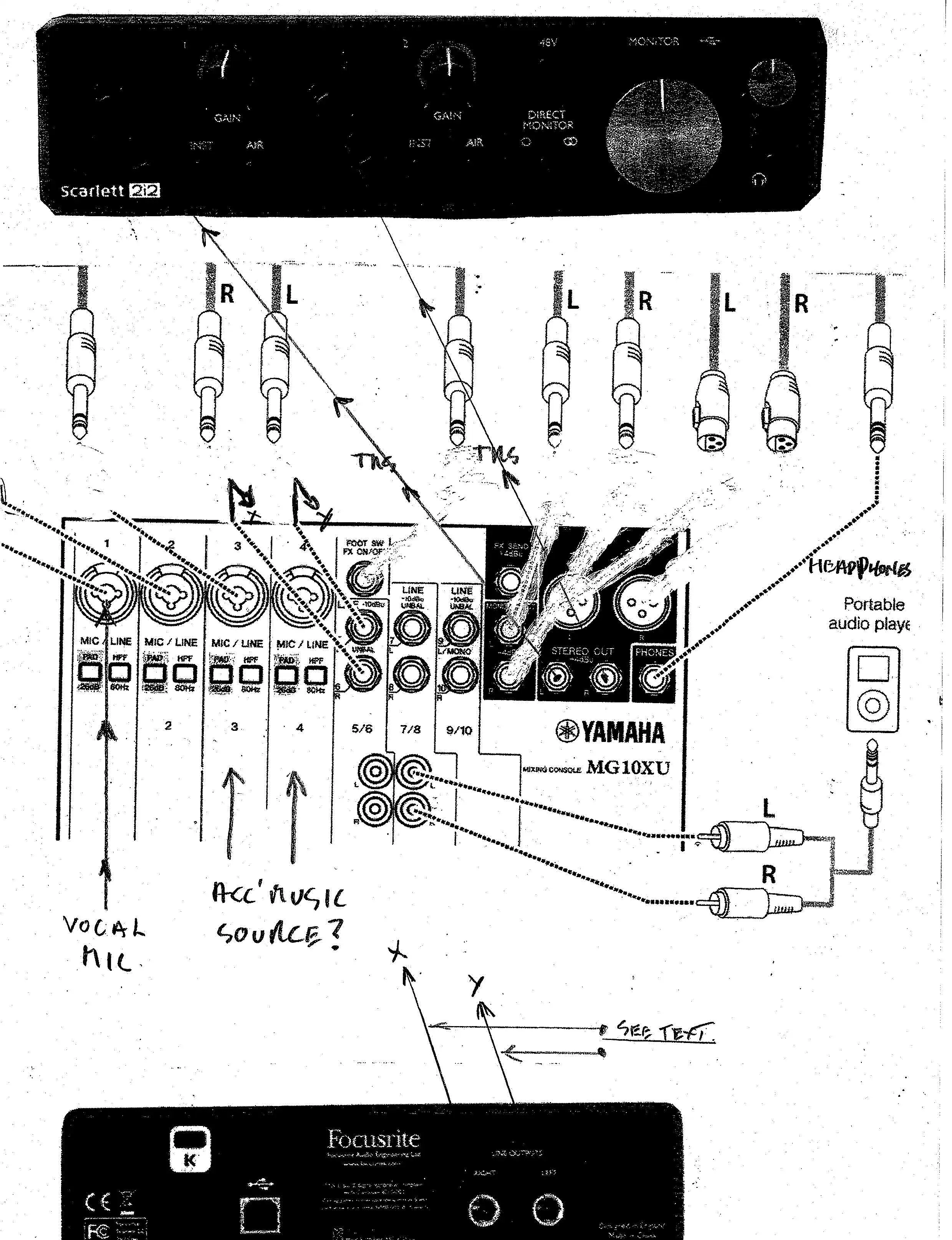

Thank you Daria, she is fine just time consuming treatment.
I hope the picture attached helps (I Tippex out some lines hoping to make things clearer? Not sure it helped!) But I suggest you don't do that yet for two reasons...
Yes, we need to get this ground loop sorted but also, an incremental approach usually helps understanding (well, it helps THIS ancient brain anyway!)
Just power up the mixer and plug in some headphones. Leave the H/P level at zero for now.
Plug in your microphone and set 'gain' and channel level as shown in that scabby instruction sheet. A finger click should give you some indication on a channel light or/and in the LED meter strip. ( 'pan' control to centre for now)
Now don the headphones and advance that level. You should get your voice in the cans? If not you will need to check the settings. Once there you can look at the reverb effect and probably go for a whiff of 'Concert Hall'? I am pretty sure you can have that effect in your phones but NOT record it.
At this stage with JUST the mixer connected you should be getting a very clean and clear signal devoid of any hums or buzzes. If not we shall have to investigate further and it is possible but unlikely IMHO, that you have a faulty mixer.
When you are happy with the sound and the FX investigate the compression. It would have been better to get a peak limiter but such are rare to non-existant on budget mixers. I am sure however that you will be able to apply a very gentle amount of compression to keep the level up but not overload the 2i2.
Next step, connect the Stereo Outs to the 2i2 line inputs. The TRS cables are just 6.5mm stereo jack plugs each end. You could probably use TS or mono cables but, especially in view of the GN problem, balanced is much better.
So now you just have mixer feeding AI and AI plugged into laptop, the latter is on battery power, no charger. Transfer the headphone plug to the F'rite and check the sound. It should be very much the same as that out of the mixer.
That is all for now. Please let me know your results.
Ah! Forgot "see text". That feed from the AI can go back to the mixer and that means you do ALL your monitoring via the mixer. There is however a possibility of feedback. No harm but can be quite startling! Leave out those connections for now.

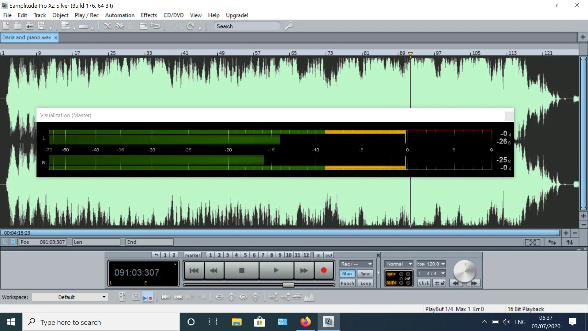

I agree with Rob, a really good start but the level is crowding 0dBfs.
Was that the level on the original recording Daria or has it been 'normalized' or otherwise modified? If the original level you are very lucky not to hit digital distortion, as Rob says, you haven't quite but pushing luck!
IMVHO the piano is perhaps a smidge too loud? This might be pushing you to 'compete' with it and the net result is a track at the limit. Hasten to add I am NO kind of mixer/musician/mastering engineer, just my opinion fwiiw. I have only so far listened on headphones, KG K92s but will put it through my Tannoy 5As later today.
But yes, overall really nice and I must hold my hand up and admit that whilst I enjoy a great deal of 'classical' music (got R3 as I type*) I have never quite 'got' opera. My wife is very keen on La Boheme Pavarotti of course and I enjoy that too.
*Been monitoring that for 10mins in Audacity and the signal has been down at -43 some of the time but not peaked above -12dBfs so far and I would expect neg ten to be as far up as it goes. Of course radio, even classical R3 has to be fitted to suit all listeners, peeps in cars for example so you can do better than neg ten but I would say -6dBfs as the absolute loudest peak?

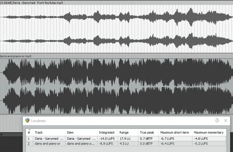

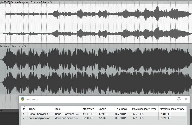

After Dave's comments, I gave a listen to his files. It sounds MUCH louder than what I get from her Youtube video. So I captured the audio and sure enough, there's a big difference. Attached a pic comparing the files, along with my capture. The LUFS on what I got is -14, but Dave's was -8.9. Also, Dave's files is very compressed compared to what I got.
Was a second file posted? Something seems amiss.
Hi Rich. I posted 3 files. One of Daria's original YT, a second of the same thing in mono and a third of a another soprano and piano. But yes, the levels are wrong. This is because I always have the sound card settings in my PCs set to max so that I get consistent results. I had not realized that in this Lenovo T510 W10, (relatively new to me) that slams YT sounds to 0dBfs in Audacity. May I ask how you 'grab' YT sound and what settings you chose please.
I am used to listening to R3 from a W7 desktop (and IE11) and the Via High Definition card is always similarly set to max. R3 never tops more than -8 dBfs V rarely -6 no matter how many 'ffffs' they give me!
The only way to decide on the original level as I see it is for Daria to attach a 320k MP3?
However, listening to the piece on my living room hi fi (via the desktop) still gives a massive piano and very 'spacey' sound to the voice. The recording is clear enough and easily good enough to show that Daria is a very talented artist but a 'proper' stereo recording it is not.
I would really like to know how to solve this YT level problem. (Rob A also found the levels high?)
