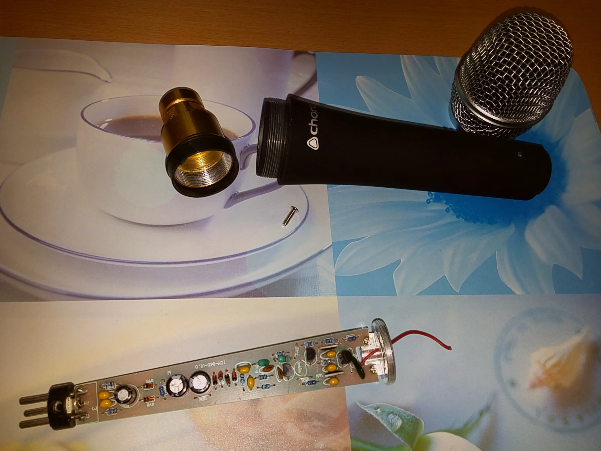

Hi there again,
I disassembled my Chord mic and was surprised a bit. I'll show you images.
First I noticed when unscrewed golden capsule casing was red wire which was torn off. I'm not sure if I finished it while unscrewing or it was already torn off before. Also soldering between PCB ground and silver thing on which golden head was screwed on is a bit wobbly.

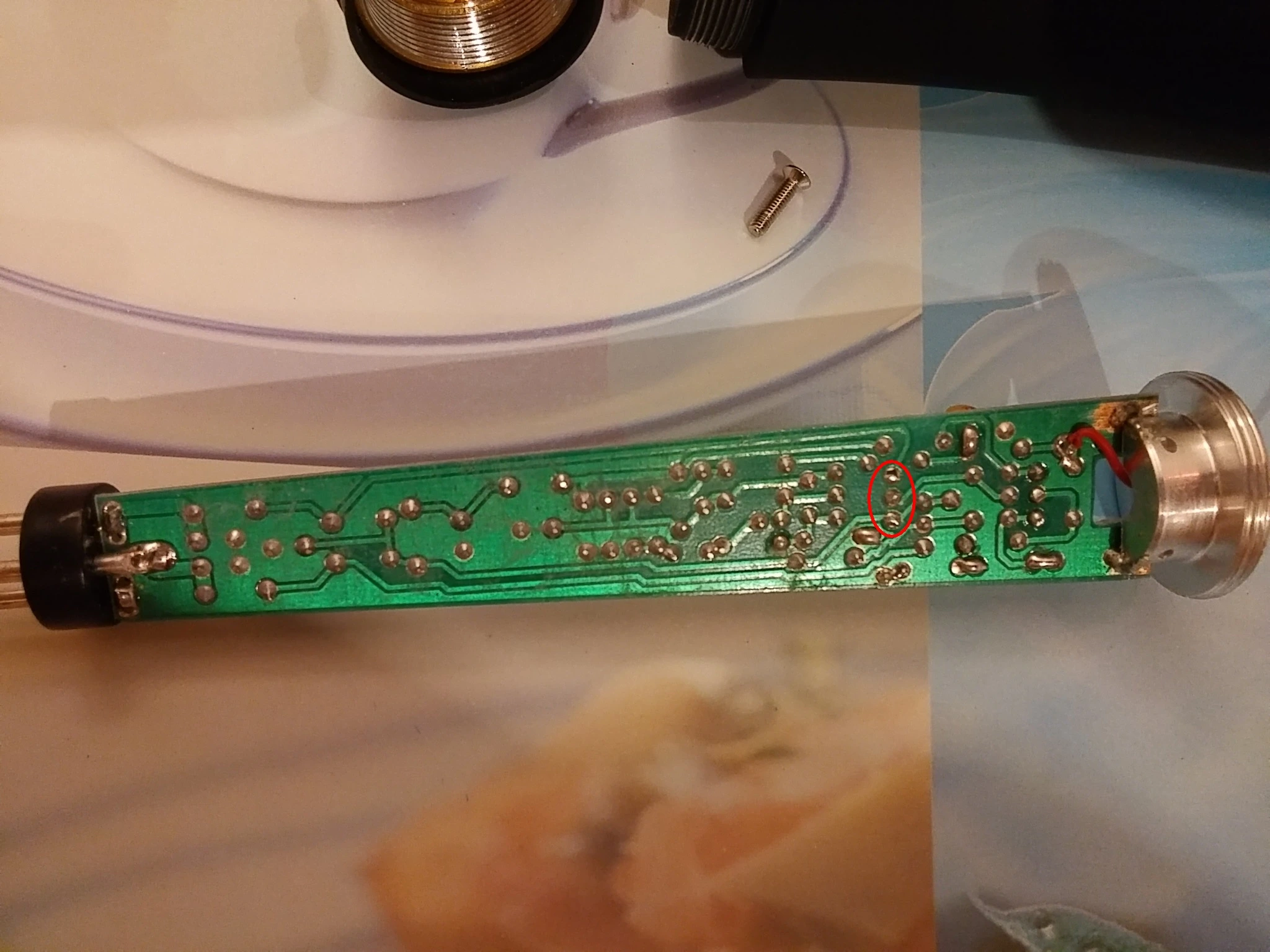

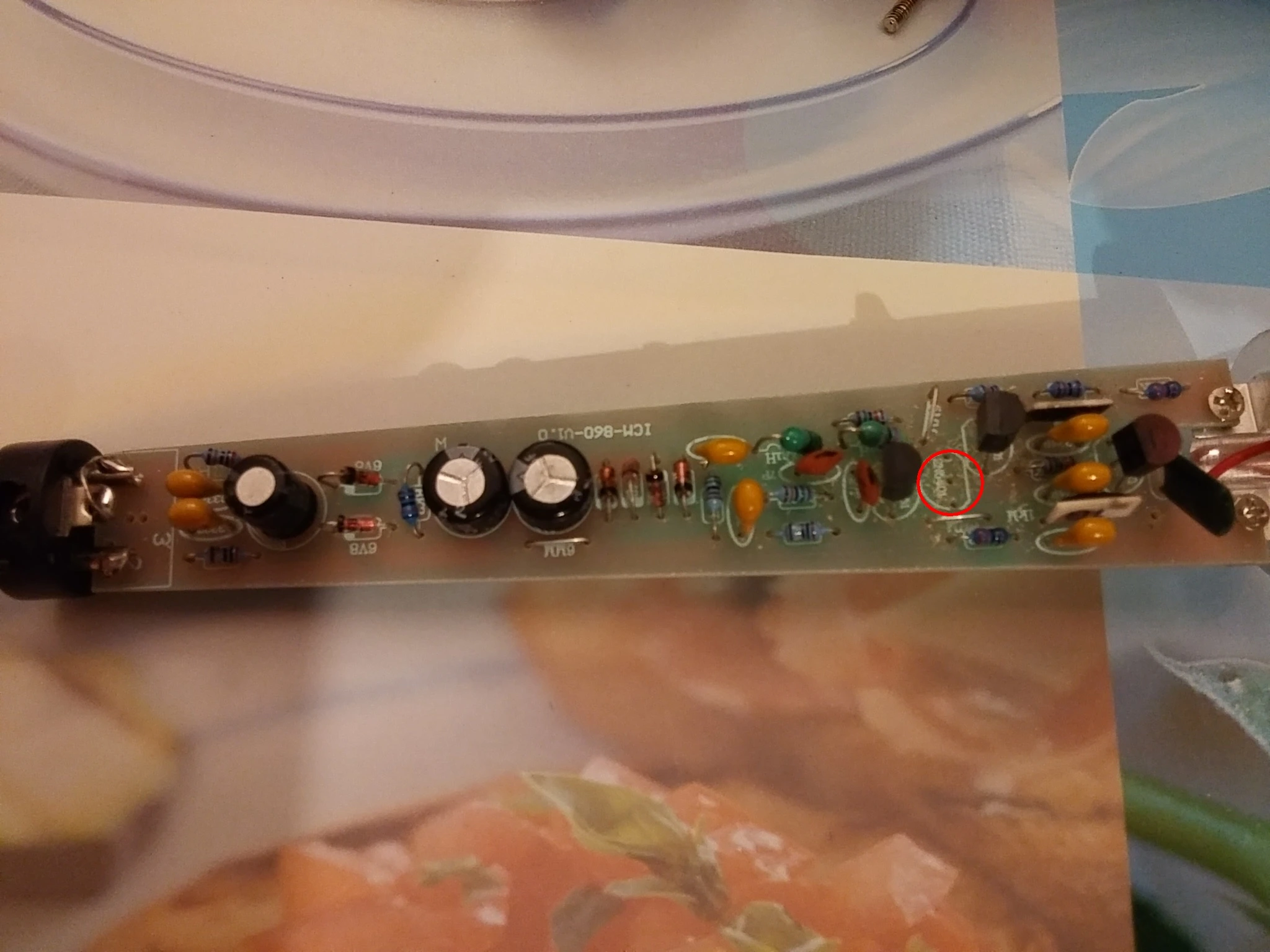

I started studying paths on PCB and noticed spot where I suspect a transistor might be missing. I marked it with red in the following picture.
Front side:
Back side:
What do you think about it. Is it possible that amazon distributes as much crappy thing that there are missing piece on PCB?
Anyway I'm thinking about trying to solder red wire to the capsule and also fix soldering on silver screwing and try what happens.
Did the mic ever work for you?
I really doubt a component is missing. It's more likely they use the same board for several variants or different microphones.
No it has never worked for me.
When it arrived, I didn't have Phantom Power Supply yet. When I tired it for the first time it was with wrong (unbalanced) cable, as I mention in initial post. Then I tried it with correct cable and it produced only noise. I disassembled it and took the photos today.
Edit:
I also can't believe there's really missing part, but you can trace PCB connection on the picture from missing part to the top pin on XLR connector and it is the only connection to that pin except for diode (which I guess separates phantom power voltage from the pin.
Ok.
If 100% obvious where the red wires goes I'd reattach it and test, particularly if there's doubt as to whether it was already like that.
You could continuity check pin 1 to the silver threading but I doubt there'll be a problem there. Looks like the silver threaded part is screwed to the board, with the board sanded to expose the copper.

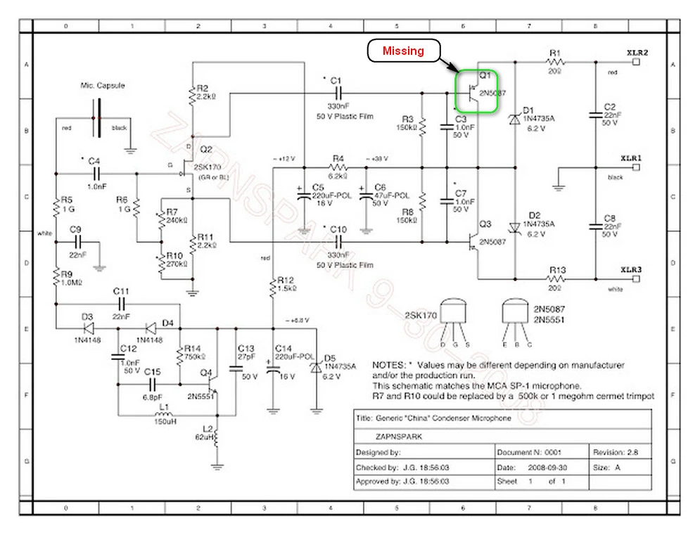

I'm pretty sure that is the same pcb and housing as the Sennheiser 865 copies that were really common a couple of years ago. I had one and it sounded reasonably OK to be honest. The only issue I had was that pcb rattling about as it was a very loose fit. I used it as a talkback mic plugged into the desk, and some punter stole it one night!
I think Taylor may be correct about a missing transistor. If you follow the trace up from the XLR(2) connector through the resistor, it leads to a point where I believe a component should be. The diagram below is a generic Chinese mic and other than the output stage I don't know how similar this is to the mic in question, but there should be a transistor I think in that empty spot to get a proper balanced output, unless some other trickery isn't evident.
Taylor, Is it all possible you may have gotten a mic someone returned to Amazon, packaging didn't look quite right or other hints? If you don't think you broke the red wire disassembling the mic and then along with the missing component, it would make me wonder if someone may have messed with it and then returned it and it didn't get checked out by Amazon or seller. If you still have a window for a return to Amazon that's what I would suggest. Even if outside the return time contact Amazon and see if they'll make good on it. Simply state not working.
Thanks for the circuit schema, very interesting.
