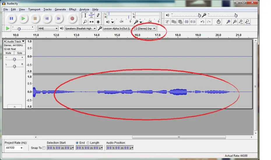

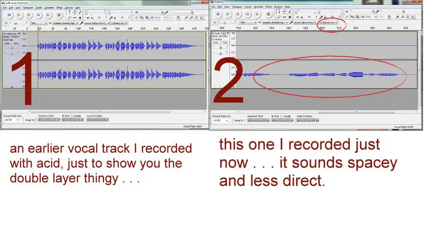

When I used to record my vocals I always remember seeing two tracks, one on top of the other. Now for some reason I only get one and the sound is very different. My vocals sound less direct and more roomy/spacey ( if that makes sense ).
I opened two tracks up in audacity just to show you what I mean. Im still learning adobe audition so I thought that would be easier for now.
I've also notiiced that my computer wont let me record in mono. I don't know if that has anything to do with it as I think someone told me once that vocals should always be recorded in mono?

All the tracks that you've pictured in Audacity are stereo tracks - even if what you actually got was just two copies of the same mono signal. In my (admittedly old copy) version of Audacity, you should be choosing Tracks/Add New/Audio Track (not Stereo Track). What happens if you do that and select a mono track at the setup (i.e. just plain Audio, not Stereo)? In other words, don't try and change the track once it's there, but pick mono right from a blank start. It should say Mono in the grey square on the left.
If you start with a stereo track (as pictured) and then try and change it to mono in the little red box that you've circled all you'll get is half a stereo track (which looks like what you've got in picture 2).

That second waveform is on the right channel, probably from input 2 of your interface. Input 1 likely goes to the left channel. Are you sure you are choosing the input in the DAW that matches the input the mic's connected to?

Assuming that you have a regular type of microphone it will output a mono signal. If that's the case then the double 'stereo' tracks in picture 1 will be the same mono track recorded on both tracks. That is not the same as proper stereo where you want tracks that differ in some way.

BSG is right.
The stereo recording you did only had signal on the lower half, which is traditionally right.
Right is usually input two on the interface, so is that where your mic is plugged in?
Either tell your software to record from input 2 mono, or move the mic to input 1.
