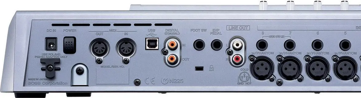

If you have a digital pre with SPIDF output then you can go digital into the BR1600 at either 16 bit 44.1kHz or 24 bit 44.1kHz, into the SPIDF in jack using and appropriate cable.
Cheers
Geoff
Do you use the "Digital In".......as the SPIDF in?

Page 261 of the main manual Gorty, digital in assign. Looks like they patch to track one & two only.
Geoff
Geoff
Cool, so on my external mic pre-amp I can output a stereo pair of tracks and input them through the digital in on the BOSS to tracks 1 and 2? If so that's fine, if I need to move the tracks I can just move them to tracks 3-8 etc.
Less effect than the impact of the BR1600's AD conversion that goes on afterwards I'd say Gorty.
So ideally, the best way to go with using the external mic pre's is to go straight in the DIGITAL IN.
Yep, that's what I'd do, then, as you say, move them to the tracks you want them to be once they're in.
