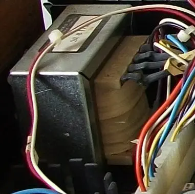

It's an old synth that a friend has. I'm asking on his behalf. Don't know the specifics, just want to get a general feel for things and this is helping so thanks! At least we'll know "ballpark". Not sure what type of supply but it does switch from 120 to 240. Here's a photo of it. You mention "regulator" and that's interesting 'cause the batteries are right next to it, which are leaking. But why was it working before and then after a long night being ON, not working anymore? PS overloaded perhaps? How would a voltage regulator go bad after what had transpired with the unit? Then you add the buzzing and all the others...? What's your hypothesis?

That's just the main transformer there Daniel...how many batteries go into it and how old is it?
See where the wires go down to a PCB? That's where the regulator would be. It converts or rectifies the stepped-down AC voltage to DC...probably 9V.
