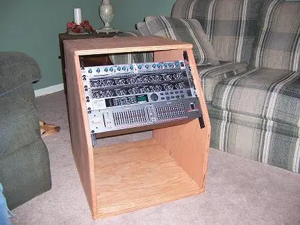

for anyone out there looking to buy any rack mount furniture, i highly suggest building it yourself! what would probably cost $300.00 or so to buy, cost me all of about $75.00 to build!!! i bought a 4x8 sheet of cabinet grade 3/4" oak plywood from lowes ($45.00) stain, and polyurathane ($16.00), and 2 sets of rack rails about $20.00 or so. out of that i got 2 rack mount systems able to hold up to 8 pieces of gear in the top, and 2 power amps (or 4 more pieces of gear) in the bottom. this is what my son and i came up with in about 4 hours!!!

The bolted in equipment completes the cabinet, forming one of the sides. Same way I did mine:

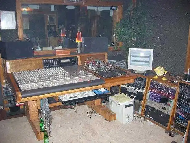

Yeah, I built my racks and console stand. I figure I saved over $1000.

Track Rat...
Looks like now that you've finished your racks and your console stand, that you need to build yourself a coffee table for all those beer bottles :)
Velvet Elvis
Beer bottles in a studio is a sure sign of........something.

When I loaded my racks in the above pictures, I put the deeper gear at the bottom. I did this so the larger, heavier gear is at the the bottom, and so that the shorter gear (towards the top) doesn't block the vents of the lower gear.
