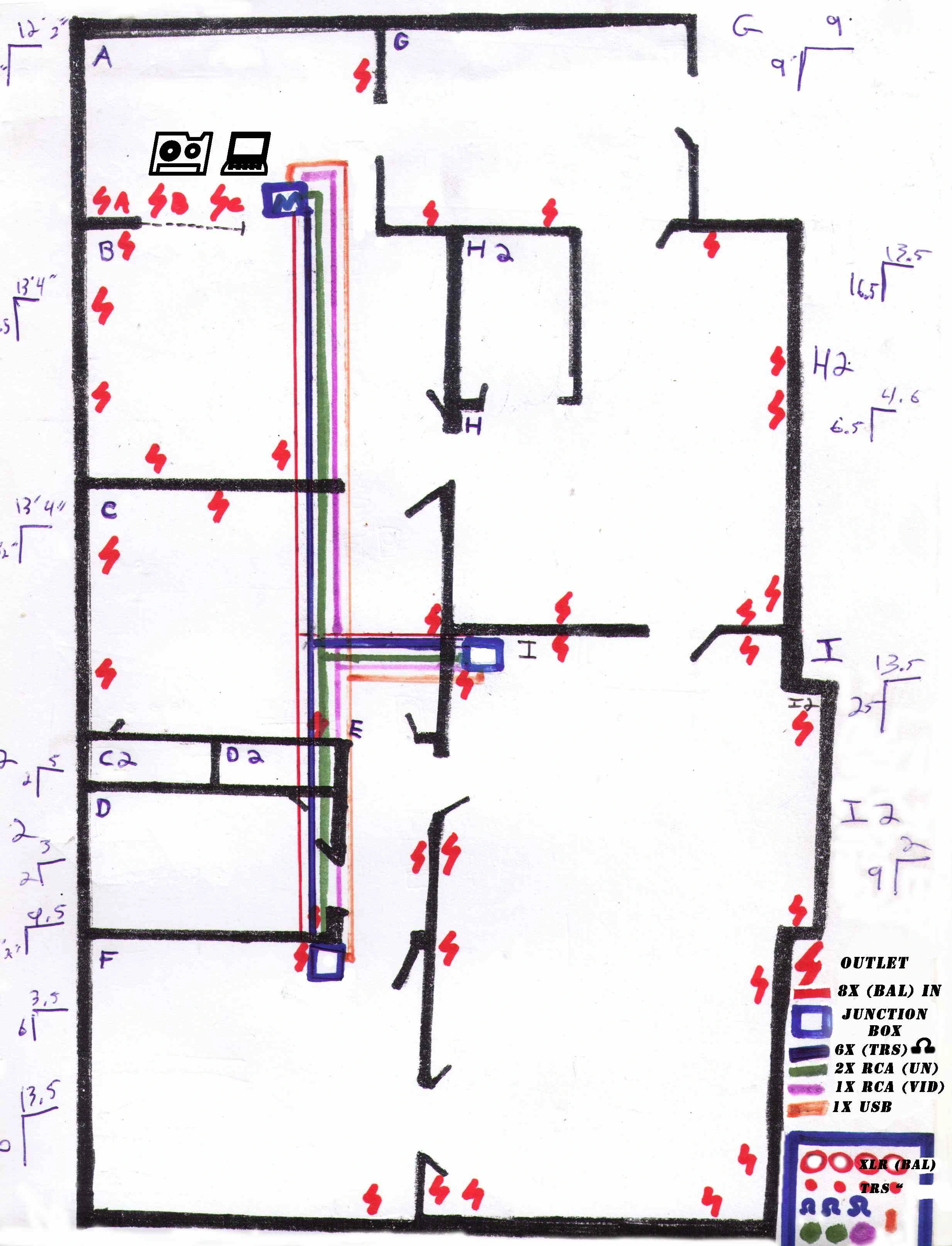

-The Plan-
A 32 channel mixer w/ timecode to record 16 tracks and send 16 tracks. It will all go to my computer and also 2 mixed tracks will go onto tape (with the possibility of sending just the 2 ribbon mics live style) while it all still goes to the computer also. When I sell my current deck and upgrade to a 2" 16 track tape machine (then 15 tracks plus timecode would also go to tape).
20% of the final mixs will be "modern recording style, or be 48k for film ADR.
80% of the final mixs will go from 24/88 WAV to mono 45 RPM record mastering.
I plan to run "a snake" under the house from my mixing room in the back, to two junction boxes in two other rooms about 40' away.
It is detailed on the floor-plan.
The snake would contain;
16 balanced lines in
12 TRS out (6 headphones)
4 RCA (audio)
2 RCA (video)
2 USB
An Ethernet or two
-The Rooms Acoustics-
Ideally I can use five of the rooms for recording (C,E,F,H and I) their sizes are in the floor-plan.
"H" and "I" are both hot, live rooms.
"I" will be my "main live sound room", "E" is a hallway perfect size and sound for a vocal booth,
"C" Is on it's way to being completely dead and
"F" is balanced about half as dead as "C" (or mostly dead), but it slightly bleeds into "E" and "I".
My goal is to use "i" as my main room for live sound from two ribbon mics, while every other channel mics an instrument or an amp. Having the other rooms is nice because right now I can put my guitar amp in one room "F", bass in another "C", vocals in the hallway with the PA micd in "H" and all of us with drums in the big room "i". This allows an old school live room mix or control over every instrument separately. This is perfect to lay down a full live mix then overdub just the vocals. ...or a thousand other overdub tweaks.
I have about half of the snake cables right now and just need to build the junction boxes and get two Cascade Fat Head Ribbon mics and a digital 32 track mixer w/ timecode. And one day a "big fat" tape recorder. Rewiring the house actually cost more and was the biggest expense I forsee. I pretty much have all the rest finally!!!
