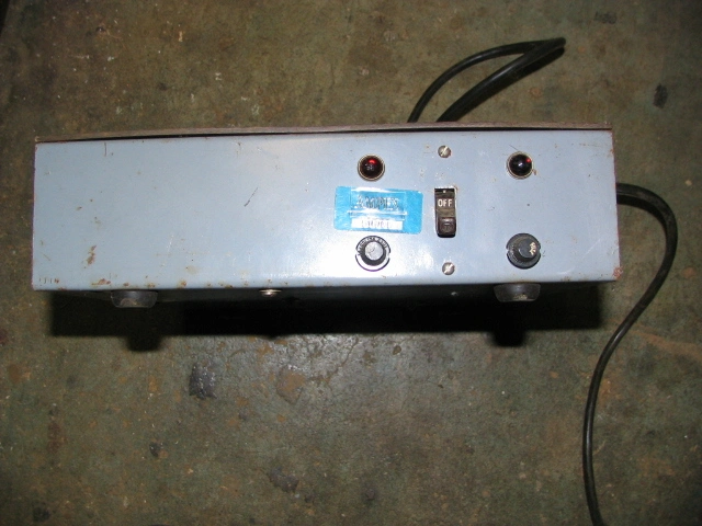

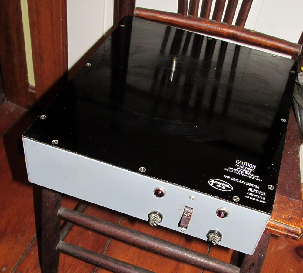

I have a tape degausser from years ago that was designed for larger reels...... (keep credit cards with magnetic strips far away)
Both good points. I never tried metal reels. I would think that would impact the results
I keep hoping to find one like that at a decent price in good condition, since now I have a lot of 2" reels, which I wouldn't ever try to erase with anything smaller...other than using the deck, but I would rather have a quick bulk demag.

I've never done a cassette and this vid seems "quick". I usually go closer to a minute on 7" reels - most of that is the exit process. Mine is a quarter the size of the large photo above - with the spindle in the upper corner. Somehow the cats dropped it 5-foot from a shelf
