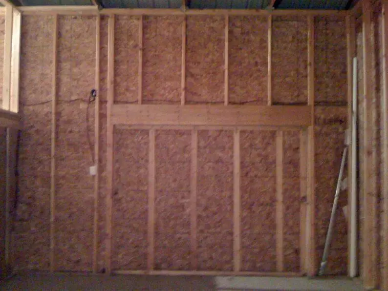

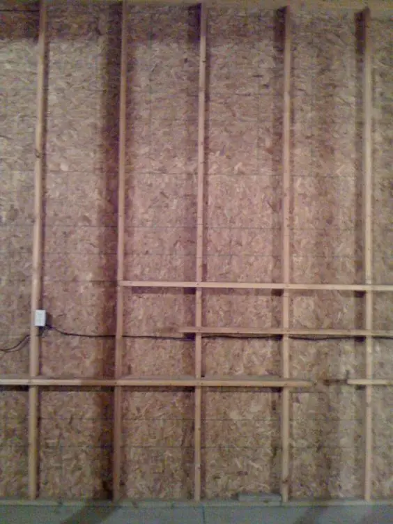

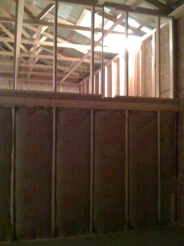

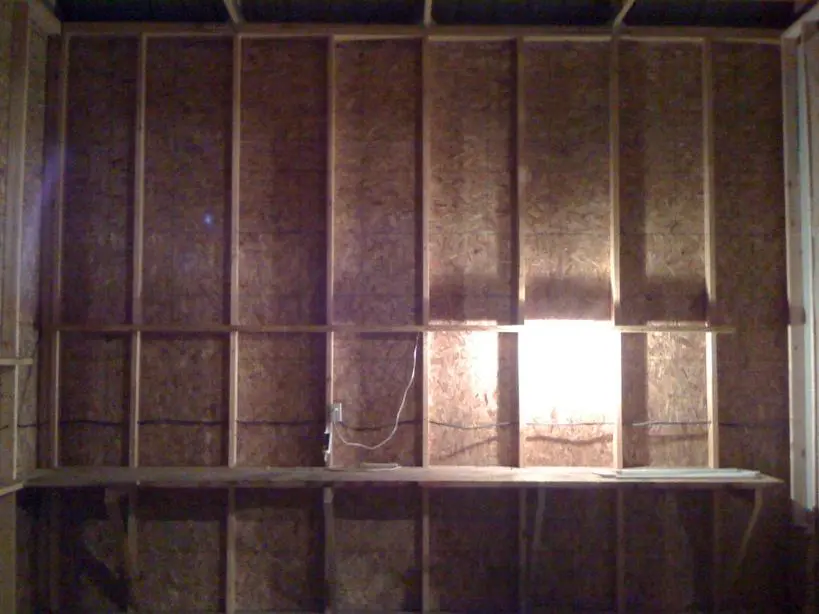

Well, after 5 years, here I am with similar polebarn size with different application. Pretty much want to convert my 24 x 16 x 12 high stall of my polebarn into a nightclub. Currently I have purchased 1000 sq ft. of Ultratouch R-19 for $460 (yeah, got a good deal from a contractor that had leftover and wanted to get rid of it). Here are some pictures.
Questions:
#1 How would I soundproof the ceiling?
#2 Once I fill the walls with Ultratouch, do I just need to put in the 5/8th drywall?
#3 How do I soundproof the wall with the big sliding door?
#4 One side already has R-13 fiberglass in there from previous owner. Should I put in drywall, 2inch Polystyrene, and another drywall?
Thanks for your help guys. If you're still around!

Questions:
