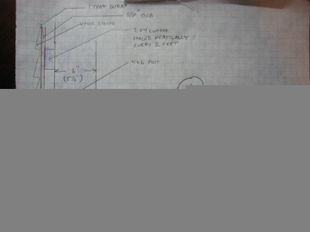

Well I'm back with some details.
I'll get right to the point:
I have attached several JPEGS showing my current construction. The OSB in the walls is 5/8" and 7/16" in the ceiling. The picture of the "Eave Detail" shows T-111 for siding. Refer to my sketch for the actual materials wich are from the inside out: 5/8" OSB, Tyvak Wrap and Vynil Siding.
I hope this works. I'm new to posting pics.
Looks like you got about half of your drawing for some reason - no hurry though, I'm on 12-hour graveyard thru Christmas so take your time... Steve
Eave Detail:
Please note the 2x12 shown at the inside top of the 4x6 pole is the only lumber that protrudes inward and beyond the 4x6 pole itself.

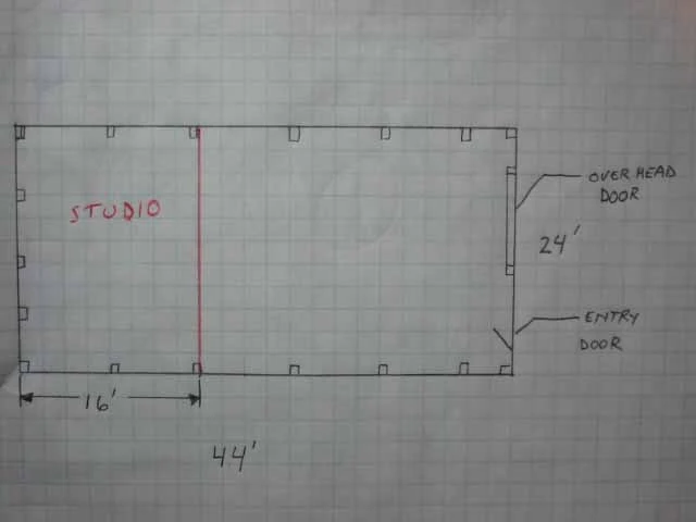

Plan View of Pole Barn:
The overall size of my barn is 24' x 44'. My studio will be at the back and will be 24' x 16'. The height from floor to bottom of truss is 12'. The poles are spaced approx. 8' apart and the 24' dimension is taken from the inside side of the OSB.
You say that the only lumber inside the 4x6's is that 2x12, yet you show a 2x4 girder block just under the 2x12 - does that block extend all the way to the floor?
Is the cement floor even with the outside of the poles as shown in your floor plan?
And am I correct in assuming that the space between your sheathing under the vinyl siding, is really where the horizontal 2x4's are placed, and that they run horizontally as mentioned, but are spaced vertically every two feet?
Are there vents in your soffits so that the roof can breathe? (This is important for ceiling details so we know what to put in for an inner ceiling)
Gotta run, more later... Steve
No. Sorry. Actually there is no block at all.
Yes the cement floor is even with the outside of the poles. In other words, it is also even with the horizontal 2x4 side girts (as they are called)
Yes the horizontal 2x4's are directly under the 5/8" OSB sheathing and the 2x4's are fastened directly to the outside of the 4x6's. From the inside of the barn you see the 2x4's with the sheathing fastened to them on the outsides.And yes, they are spaced 2' vertically.
One more minor detail: The 4x6's at the back of the barn are turned 90 deg so the 4" dimension makes up the wall depth.
The barn is completly unfinished on the inside with the exception of a 100 amp service panel, a few oulets and lights. I will be able to do all electrical work and construction. HVAC will be contracted out. I have a ood lead on an HVAC guy that was recomended to me by a studio owner.
The soffits are so that the roof can breathe. The eave detail shows the trusses sitting on top of the 2x12's which are fastened to bothe sides of the 4x6's. The trusses are spaced 2' on center.
Sorry about the picture showing up 1/2 way. I am now on my daughters laptop. I screwed up my PC after installing some anti-virus software. Now I can't get on line!
I hope I have given you enough details to go by. If not, please let me know what you need and I'll get it to you ASAP.

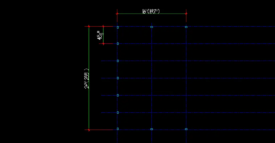

Well, it looks as if I'm going to have to join in this one. I am a detailer. Consequently, I deal in REAL dimensions, otherwise how can one describe EXACT details here. Sooooooo, I'm here to help. If you don't mind. All I'm here to do is interpret what you and others say, and put it in a form for everyone to see in its correct existing reality, so when Steve and others want to tell you something, they have real stuff to show. Therefore, here is our starting point. The existing PLAN.
What I need, is accuracy. Not generalitys. Thats the only way my help can truly be utilized. So, I need you to confirm some things if you don't mind.
First, the 24' dimension. Where is it REALLY come from. The outside corner of the corner of 4x6, to the outside corner of the opposite corner 4x6? That is the way I drew it. However, if that is correct, then it should be EXACTLY 288" from the inside face of the 2x4, to the inside face of the opposing 2x4 on the opposite side of the room.
Next, the 16' dimension. Where does it REALLY start and end. I drew it as staring at the outside corner of the corner 4x6, to the centerline of the THIRD 4x6 from the corner, includiing the corner 4x6. Please verify EXACTLY the dimension as shown.
See how hard that is to describe. Therefore, we will set up descriptive names for the directions(NORTH,SOUTH,EAST, WEST) and the grid lines of the colums. See the pic below for the gridlines. For our information, tell us which direction the left wall(24' dimension) faces. That should be the wall that is the left end of the WHOLE building, as per YOUR drawing. I did not lay out the whole building. Only that portion which is to be your studio. At least for now.
I have assigned a set of grid numbers and letters to describe the column centers. You will see this in the SECOND picture below. I have to post a reply for every picture that I want to show right in the post. But from now on, MOST will be a URL on my server. That way I can post numerous pictures, unless I REALLY want to get your or someones attention.:D
Next, I need to know EXACTLY, where the slab dimensions are coming from. In my mind, the inside face of the OSB SHOULD align with the edge of the slab. The outside face of the 2x4, also should align with the edge of the slab. Otherwise, how could the OSB seal the building. Although I've seen buildings where the builder didn't have a clue to what he was doing. If the slab extends beyond the vinyl siding, OH BROTHER, that would mean moisture would collect on the top of the slab and wand to weep in under the osb and siding. So, please verify these details right from the gitgo. AND, any other relevant oversights. OK. However, if you don't need this sort of help, just say the work and I'll butt out. If you DO want my help, then provide these answers and we will start out on the right foot. Cause everything you do from this point out, will be determined by what is existing, and the help here will only be as good as real existing dimensions given.
Ok, I am labling the far upper left corner column, as a vertical gridline noted as "A", which in the FIRST drawing, is shown as aligning with the outside face. That was for 1/4" scale plan overall dimentsions. However, in the detail, the actual grid is on the centerline. The horizontal gridline, aligning with the LONG wall of the building, is actually the center line of the CORNER post, which has been turned 90 degrees from the posts inbetween corners. It is labled grid "1". I will clarify this later, after you supply some dimensional answers. Like for instance, IS the dimensions given for a 4x6, REALITY? Most lumber now days, ard labled in NOMINAL dimensions. 2x4, 4x4, 4x6, etc. However, their TRUE dimensions, given shrinkage and small variances, will be somewhat smaller. Usually, by nominal standards, a "2x4", is 1 1/2"x 3 1/2". The reason I ask, is I have found MANY instances of custom MILLED material that is the actual size of material that is given in nominal dimensions. Old 2x4 etc, from as late as the 60's, were the actual size of the given dimensions. Thats why I asked.
Anyway, lets get going, no time to waste here. So here is the starting grid plan and a detail of that corner, labled A/1. See how easy that is. Cool. So, let me know. If you really don't need this sort of help, good luck with your studio, as it is the ONLY real help I can offer. Acoustic and constructional help is already answering here, drawing is my expertize, as well as construction and fixture detailing, and actually, by the time you finish these sessions, you could probably use these plans as a backbone for many other things. Electrical, HVAC, Permits, etc. But the choice is yours. Its only an offer.
fitZ:)

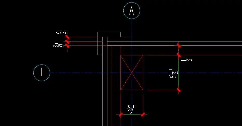

Here is the corner detail. I assumed a couple of things.
BTW, after viewing this here, I see the conversion from .dwg to .gif, is less than high resolution, as some of the dimensions text, doesn't SHOW UP. Crap. Sorry. Nothing I can do but clarify as we go. Damn.:rolleyes:

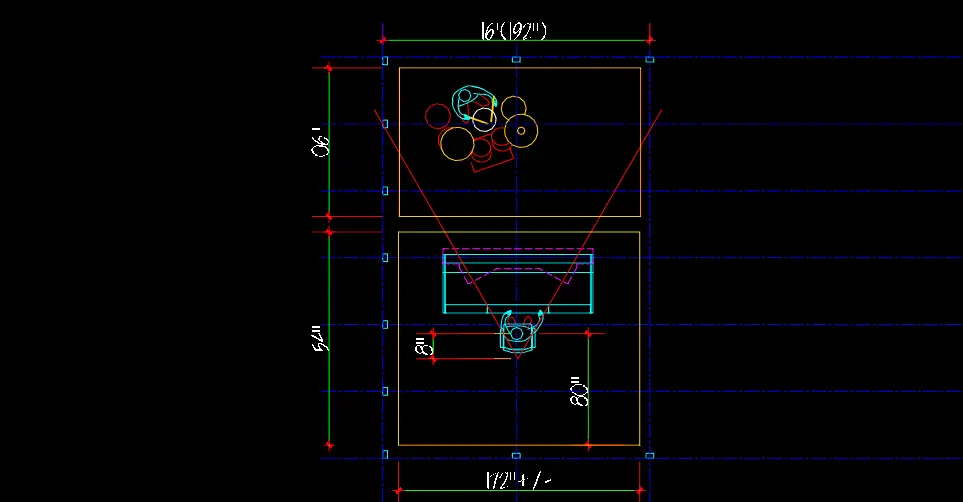

Hello Jeff, I decided to include this little layout from templates I have in my studio files, just to give some scale to your space. This is by no means an actual layout. Sometimes, a blank drawing, with nothing to gauge size, leads to unrealistic conclusions. Hope this helps. The items are drawn to scale so you can see what you are working with. Usually, people overestimate the space they have. Especially when they start to enclose rooms with in a room.
Also, the dimensions shown, when converted to .gif, loose the number 1 for some reason. At least in vertical dimensions. For instance, the dimension 8" should read 18".
Which is where your monitors should focus behind the engineering position. Others are 106", 154" etc. What a crappy way to do things, but its the nature of conversion from high resolution to low for posting here.. Sorry
fitZ:)

From your drawings, it appears that your roof trusses are 2x4 - are these actual engineered trusses, and if so can they support two layers of wallboard on their underside? If so, that's your first leaf of your ceiling. If not, a different approach will be needed.
One way to handle this would be a completely separate inner frame, including ceiling joists of 2x12's on 24" centers - your inner leaf would go on the inside of this frame, with resilient channel supporting the inside layers of ceiling wallboard - the outer leaf would be a little tricky, because you'd need to make one continuous leaf of the outside wall and the double layer of wallboard placed on the top of your new 2x12 ceiling joists. The area between the inner and outer ceiling would be heavily insulated, with at least 12" spun fiberglas batts. The inner ceiling layers would be suspended on Resilient channel, for an improvement of around 10 dB - about 49 dB without, 59 dB with the RC. That's figured using two layers of wallboard each side, one side double 5/8 and the other side using one layer of 5/8 and one layer of 1/2". Note that your low frequency Transmission Loss won't change with or without the RC, since that's pretty well maxed out by the 2x12 joists. These will be necessary, BTW, more because of span limitations with 4 layers of wallboard.
The main thing you need to look at right now, is a way to continue your outer OSB layer across the ceiling with no breaks in the mass layer - if that's not feasible, then the new ceiling joists can take enough weight to handle it and you'll only need to figure out how to bridge between the outer ceiling layers on top of the new joists, and the outer wall so that is one continuous barrier.
