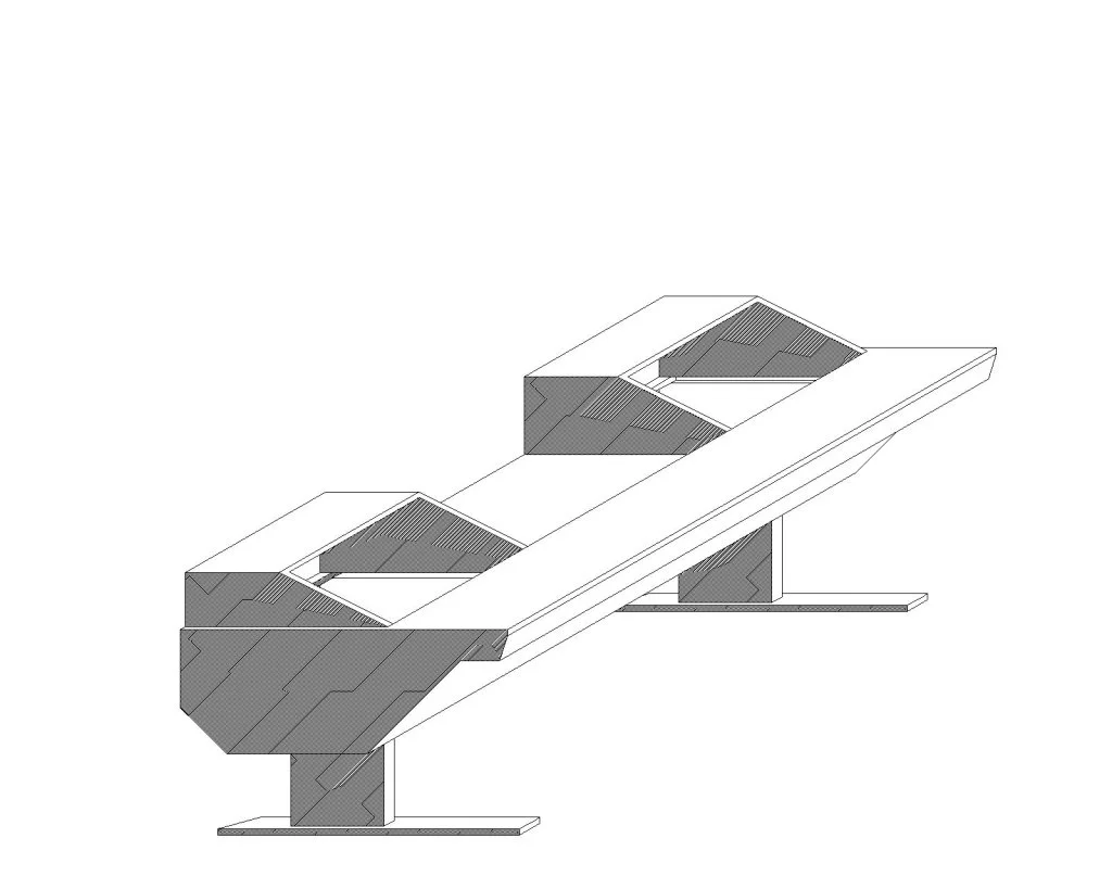

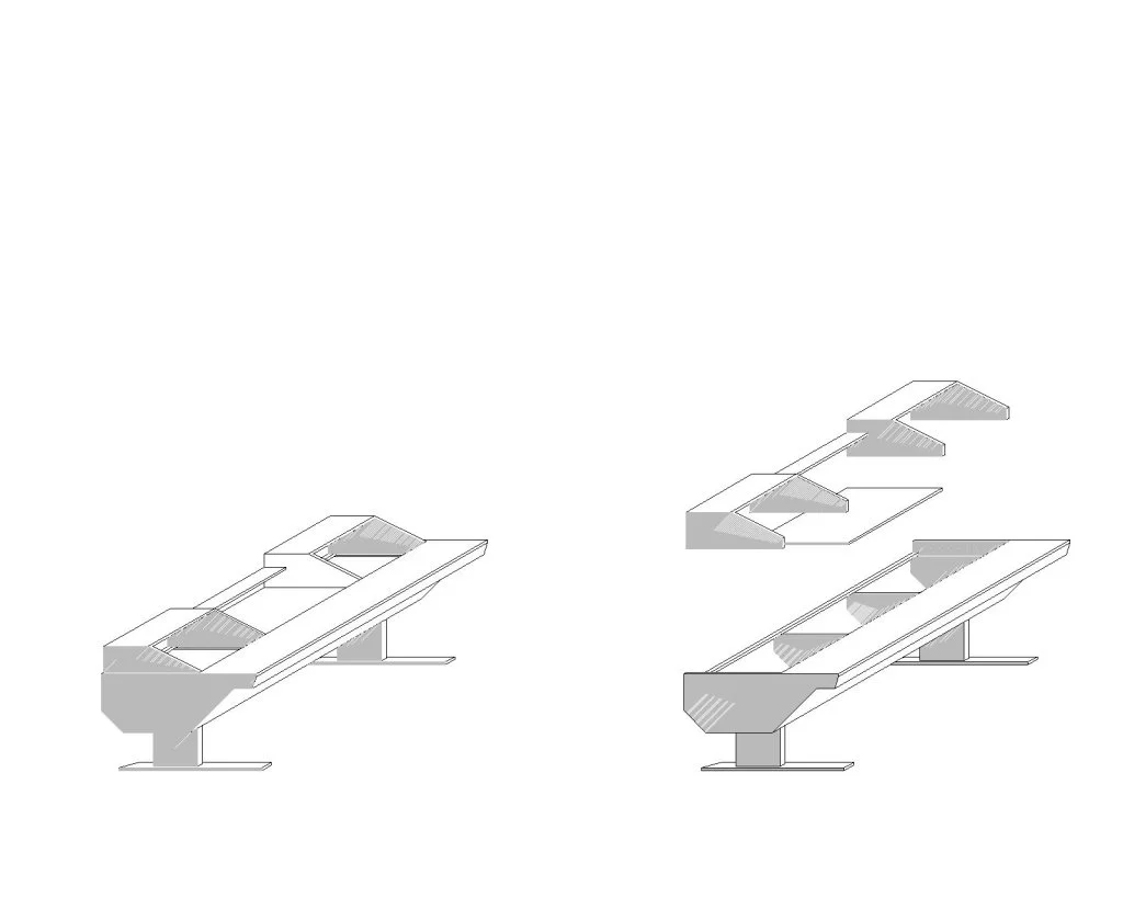

well, i have decided to build my own desk. here is a makeshift 3D of what i am planning. it is somewhat modeled after the argosy 70 series. i will keep yall posted with picks of the progress...

Put a bridge across those two racks for monitors maybe?
i have thought about that. i am actually making the top recessed section modular, so if i ever get a large console or something again, i can remove the racks and put a flat shelf in. i am sure i can do the same with a back shelf. i was planning on putting my monitors (speakers) on the top of the racks. as it is right now, my DM24 (used as a control surface) will go in the recessed area in the center.
with a bridge

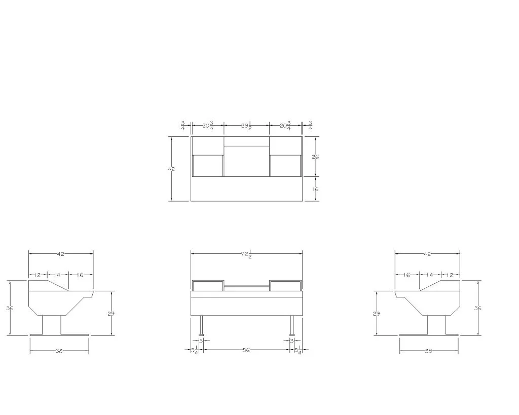

and also an image with dimensions
width is actually TBD

An elevated bridge will be a bad idea after long hours at the desk. Ideal computer screen placement should be where the top edge of the screen is at or below eye level. Anything higher puts unnecessary strain on neck and back. If anything, the monitor should be at a lower level than the main worksurface.

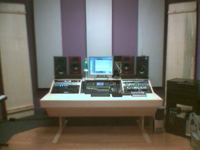

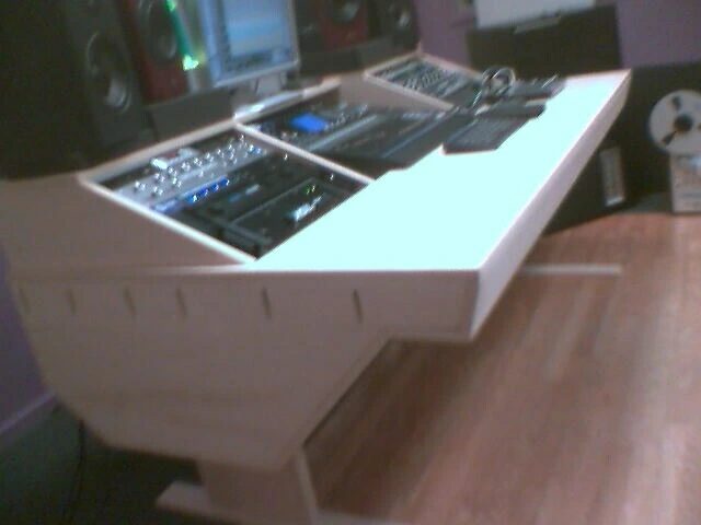

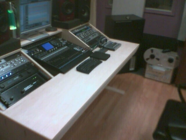

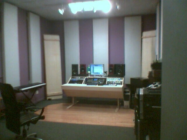

finished it saturday. wahoo. havent got it stained yet. i will post some pics later today anyway. i could not wait to get my gear in it. ALL my cables are now inside. i have no mess all over the back of the gear like i used to. i can actually walk all the way around.. ;)
Make sure to get us some pics. I've been interested in building a simple desk for my board, basically just so I can have a better place to put my monitors and better organize everything, but I lack in wood working skills. What kind of wood did you use for this?

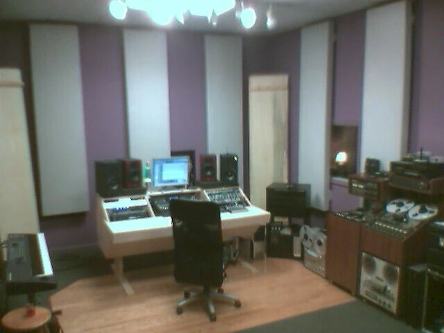

sorry, my camera phone sucks. here are some pics though. it is made entirely of 3/4" maple plywood. i am going to stain it black (not paint, stain) then i will put some 1 1/2" thick solid wood caps on the ends and stain them a pecan or something light brown..

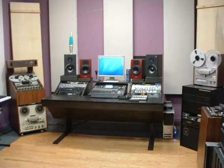

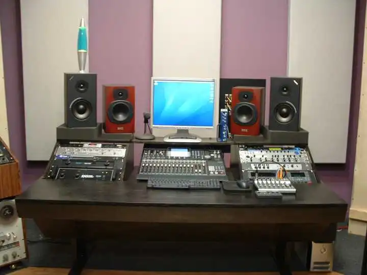

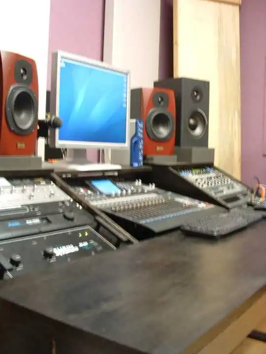

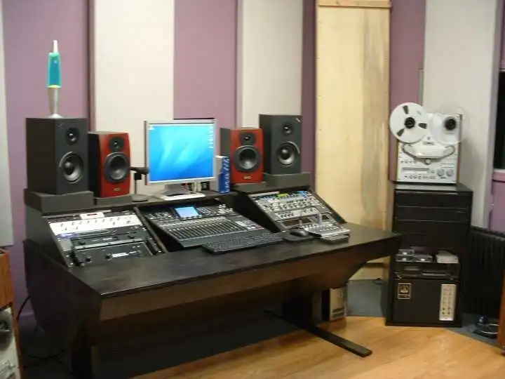

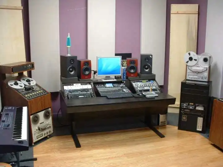

finally got the stain on. still working on the mahogany end caps

sorry the pics are kinda crappy. there is a file size limit
That's good stuff. I love the reel to reel on the side. :)
thanks guys. gotta luv vu meters and reels.. they definately add to the atmosphere. i wish clients would actually wanna use the thing.. haha. no one wants to buy tape.
