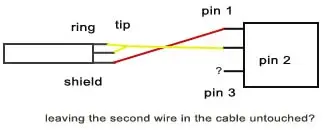

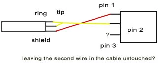

Anyway I did a very rough diagram, but only for the XLR. As for going to the RCA, I'm not sure what the inside of one looks like, so I'll attempt that later:

That's how I would wire it, unless you need to additionally short Pin 3 of the XLR to one of the others, but I'm not sure which you might need to connect it to. When I said "leave the second wire untouched" I just meant that you don't need to connect one of the two conductors to anything on either end; you just need to use one conductor plus the shield, that's all. You'd probably have a tough time finding a multipair cable that's only one conductor plus shield, and it probably wouldn't be much different in price from a two-conductor multipair. Using the two-conductor also gives you the ability to upgrade should you ever change your equipment.
