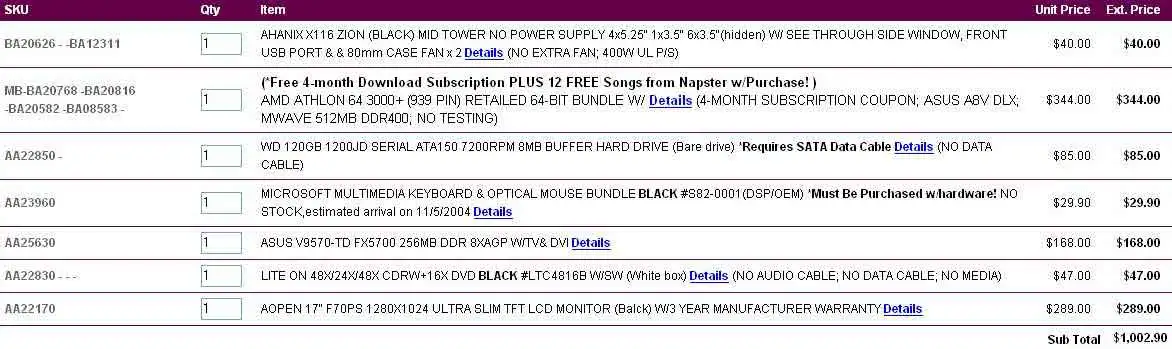

  • AMD Athlon 64 (3000+ 939 pin) based DAW using Asus A8V DLX mobo w/512MB, 120GB SATA HDD, GeForce FX5700 w/256MB, CDRW-DVD, 17" LCD (JPEG attached of config) $1000

I just don't see you being able to stay within your budget using Cubase SX. You can reduce the cost of the DAW using a cheaper video adapter (the FX5700 w/256MB is pretty high end), and swapping the LCD for a 17" CRT. Depends on your needs.
Luck. Consulting fee, if adopted, 3% ($75)

The DAW part - I am doing an AMD Athlon, ASUS board, Socket 939 (firewire and LAN connections on the motherboard), Athlon 63 3000+ chip with heat sink and fan, Antec case w/ quiet power supply (350 w), 1 Gig Corsair RAM (recommended for reliability), a licensed XP Home OS and a 7200 RPM applications file drive, 40 G for $797 from Newegg. I'm reusing my peripherals, sound interface, video card and a couple of ATA drives from my Win98 rig. Pretty good bang for the buck at that place.
