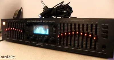

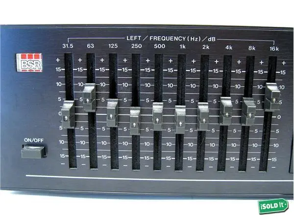

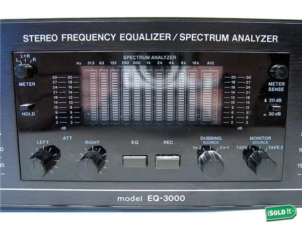

The BSR EQ-3000 is a terrific EQ to put on the tape monitor section of your receiver.
With onboard spectrum analyzer, pink noise and included feedback mic, you may use the 10-band stereo EQ section to flatten your listening/monitoring environment, considerably. That's well worth the price of admission, right there.
You may also employ it in an efx loop on your multitracker, by feeding it a -10dbV nominal line level signal on RCA connectors,... in/out of the "LINE" connectors on the back.
The EQ-3000 is also useful for a switch matrix between 2 tape drives, as well as adding EQ to the overall system.;)

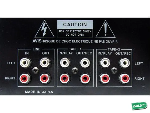

can anybody tell me if i can install my BSR EQ 3000 with my Sony Reciever. I was thinking of connecting my two devices first with EQ 3000 tape 1 and tape 2 input and then line output to my receiver input. Does anybody it would work? i tried. But it did not work.
Yes.
If the receiver has a classic "tape mon" (tape loop/mon1>2) section on the Tape 2 in/outputs, then use that. With this configuration, you may EQ the output of the entire receiver, as well as add 2 AUX devices. 70's/80's design receivers had Mon/Tape-dub1>2/tape loops sections on them.
If the receiver does not have a traditional "tape loop" on Tape 2's section, then you may still use it as an input device, (or Tape 1 input), but then the EQ is simply an AUX/EQ input multiplex device for 3 Aux devices, (but you may not EQ the entire receiver's output in this configuration). Late 80's/90's receivers tended not to have Tape-Mon sections./DA
Eq 3000.
my sony receiver has 1 dvd input, video 1 input, video 2 input/output. And in my EQ, it has got line in/out. tape1 in/play, tape 1 out/rec and same for tape 2 as well. now if you can explain again how to connect 2 aux in my eq and then transfer sound to reciever and eventually to speaker pls. thanks
On older receivers,...
Tape 2 is set up as "tape-mon", which will output and inupt signal simultaneously in a "loop". More modern receivers don't have tape-mon-loop, so it goes on a case by case basis. Also if it's labelled (Tape 1>2) would denote a tape dubbing loop or setting.
/DA
