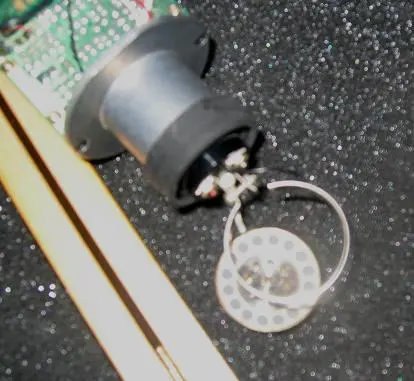

I just recieved an AT4033 I bought off eBay, and the little metal ring that holds the capsule in place is broke. Anybody know where to get a new one, or how to fix it?
Thanks in advance.
Just to be clear, i am talking about inside the mic, with the cover off. The capsule is held in place by a metal band that is around the capsule then screwed into the mic itself.......I'll get a pic in a minute.....

Peluso microphone labs sells 32mm and 34mm capsule mounts, so if your capsule is that size and has a pair of screw holes at about 4:00 and 6:00 (on the edge, not on either face), you should be able to use one of those.

There are no screws that go into the capsule. There are two at the base of the mount, and one that goes thru the two "legs under the capsule that tightents the ring around the capsule. It's gotta be a couple dollar part. Anybody know where to buy it at?

It might just be a simple matter of Putting the Capsule back into the mount and tightening the screws at the bottom that adjust the tention of the Capsule mount untill it is secure.......
You could even try a couple drops of glue to see if that will secure it, just ma sure you don"t get any glue on a diaphram....
Good luck
PS: if the Mount is actually broke you might try soldering the mount back together....Just a thought...
