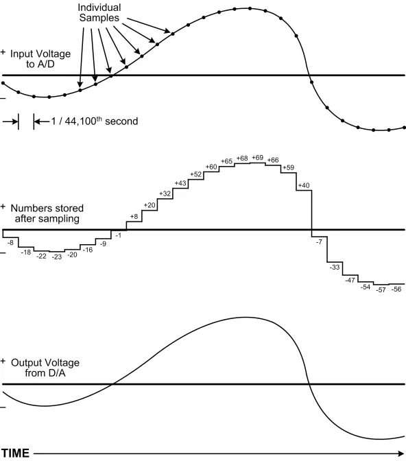

It might seem that way, but all that's affected is the noise floor. What the "resolution" arguments miss is the reconstruction filter built into every D/A converter. This smooths the output waveform thus removing the steps. The attached figure is from my Audio Expert book, and it shows how the output waveform is identical to the input, within the frequency and noise limits of the current sample rate and bit depth.
--Ethan
