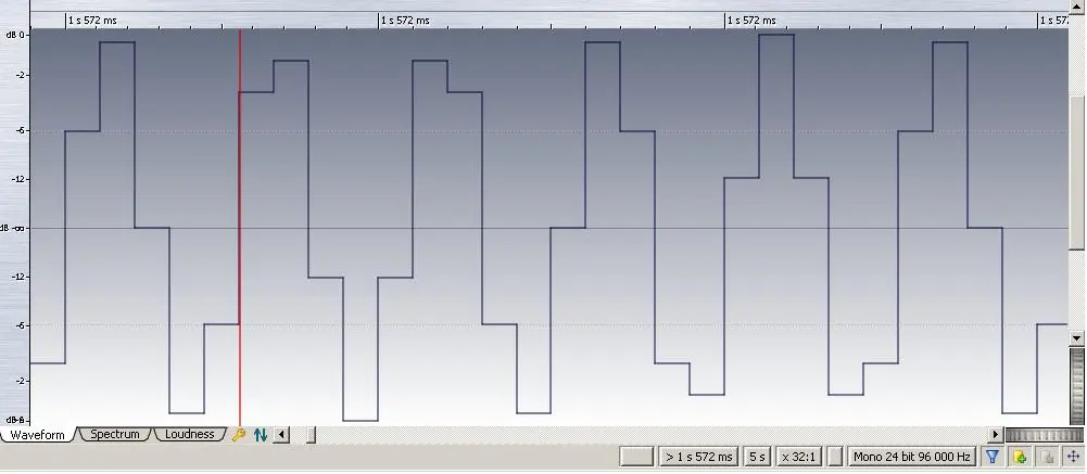

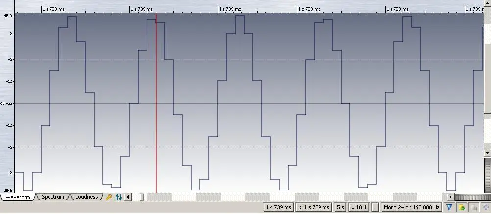

As for the shape of the sine wave, it's pretty much a pure tone with no distortion. I chose that for the examples I posted to try to get the limitations of the file format to distort the wave so it would be readily apparent and highly visible. Presumably if you can get a pure tone with no distortion to not distort, the bit depth should be sufficient to not worry about. It might also be dependant on the frequency of the wave - lower ones take longer to develop.

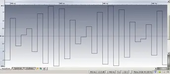

The resolution cuts in half every time we reduce the thing by 6 dB. On a simple sine wave test it started to fall apart for me at -60 dBfs at 16 bit with a 440 cycle wave. This is having the system operate on around 6 bits, or 64 discreet quantization levels. Approximately, anyway. The errors start coming in where the A/D starts to get values like say 30.98, 31.65, 31.79, 31.93, 32.06, 31.94, 31.8, 31.66, 30.97.
PCM stores the numbers as 30, 31, 31, 31, 32, 31, 31, 31, 30. Regardless of the shape of the wave, the numbers are close, the frequency is correct and the result is distortion. For practical purposes this is only going to concern someone recording the most dramatic, dynamic, uncompressed symphonic performance.
