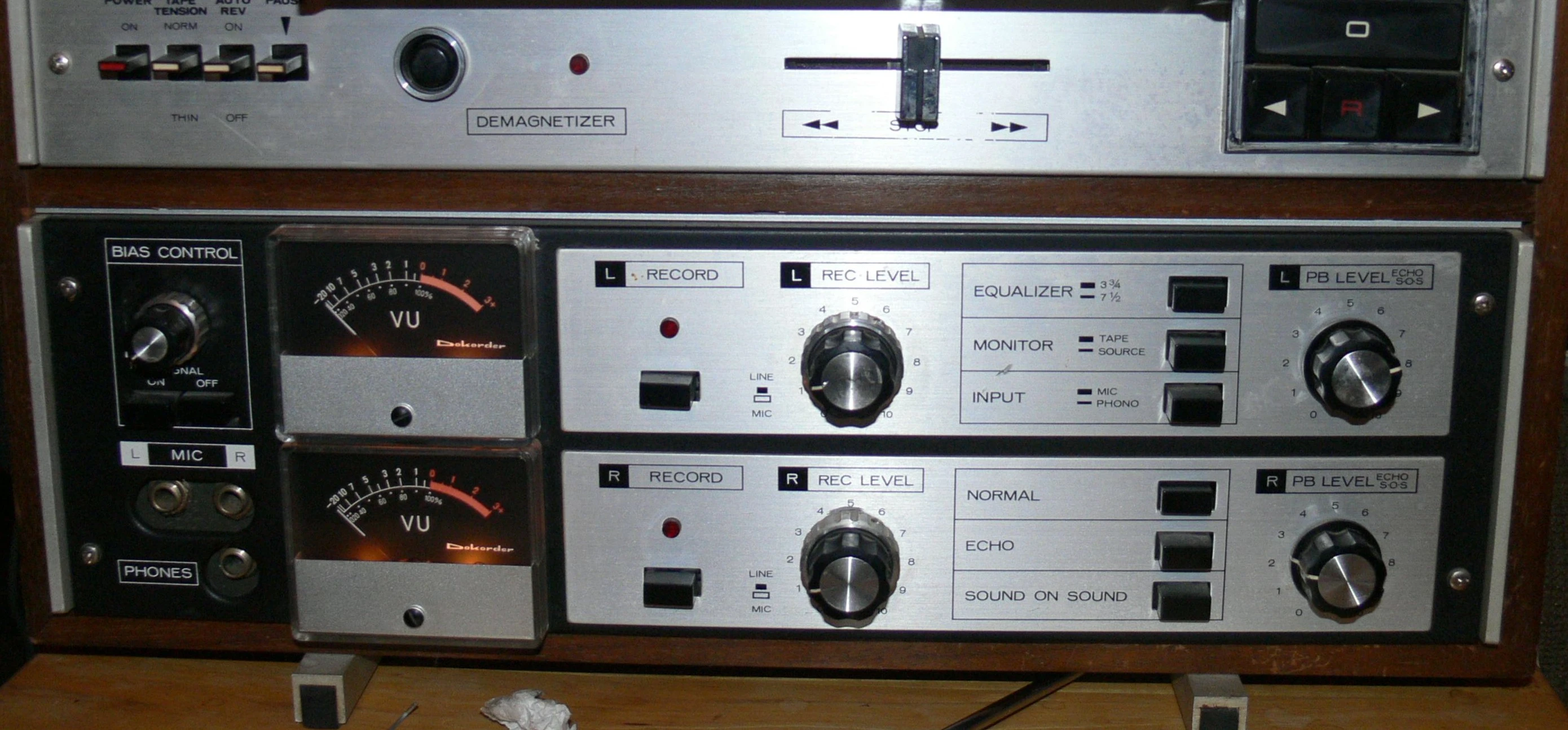

Or, press the DEMAGNETIZER button : )
[MENTION=105765]garww[/MENTION]: no tape switching on a 388.
