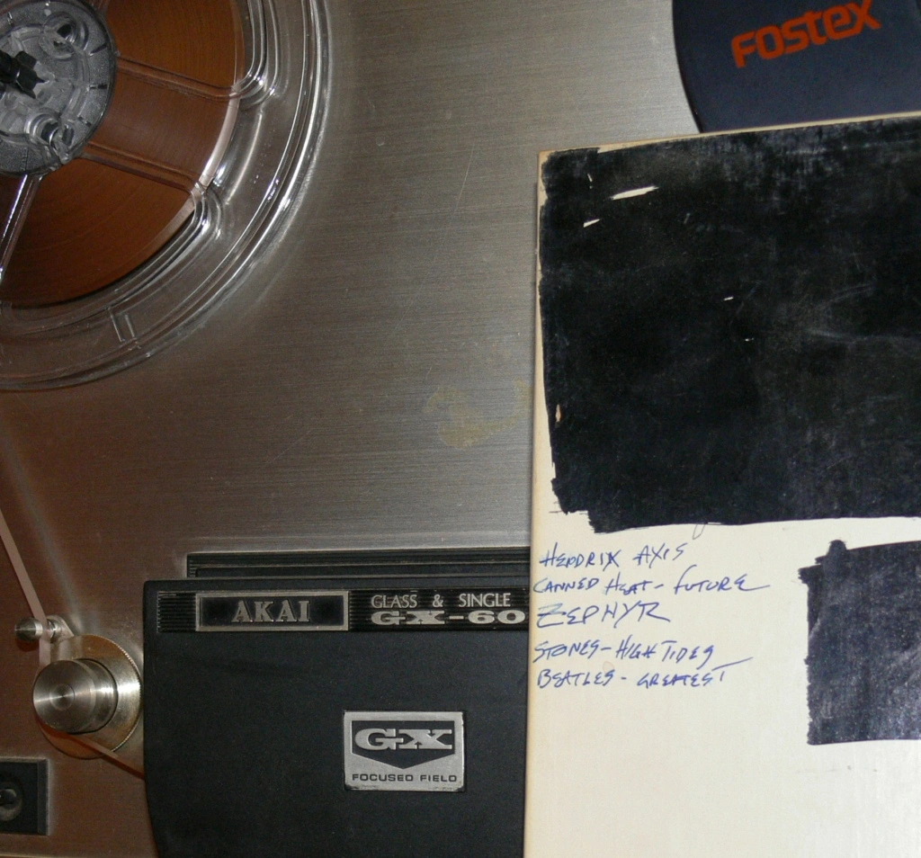

So happens I actually got around to play a tape around 5pm today. It's kicking butt at 3 3/4 on second half of a Hendrix-Axis dub from one of the first 180 gram phase of re-issue trend
