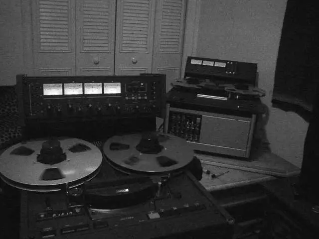

here is a picture while recording a mixdown....thought you might enjoy.
I did enjoy! I'm always a fan of picts of this sort. I like the vintage B&W Btw. ;) :)
