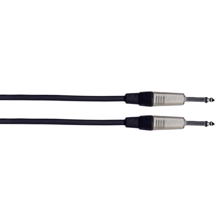

I think you're confusing things a bit, all you need is 2 x 1/4" jack to jack leads.
Left and right doesn't matter, the connectors at either end are the same normal 1/4" jack type.
http://www.studiospares.com/pd_579380_MJACKMJACK 25m NEUTRIK RICO4.htm
