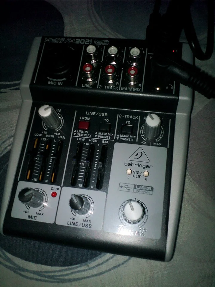

I've got "BEHRINGER XENYX 302USB with audio interface"
I hear my own voice on the headphone.
I turned of "Listen to this Device"
I listen to my own voice even though I disable all the devices from Recording Tab.
When I record on FL studio, I hear 2 voices. :-/
Help me out.
Thanks!

Hey thanks for reply.
No, because I don't have XLR to XLR cable. So i connected my condenser microphone with the xlr to 3.5 mm cable.
Have I done anything wrong?

If it's working you probably haven't done anything wrong. It's the physical buttons that determine USB routing I was mostly wondering about.

Make sure you DO NOT have the "Monitor Track" option checked in Fl. It sound like you are using your interface to monitor the signal only since you are using the 1/8 inch jack for the input signal going into your computer. This is really not the best way to do this. You may be hearing two voices due to latency. Also, depending on what headphones you are using, your mic maybe picking up the sound coming from them as well. This will also cause you to hear two voices. It's referred to as "Mic Bleed".
