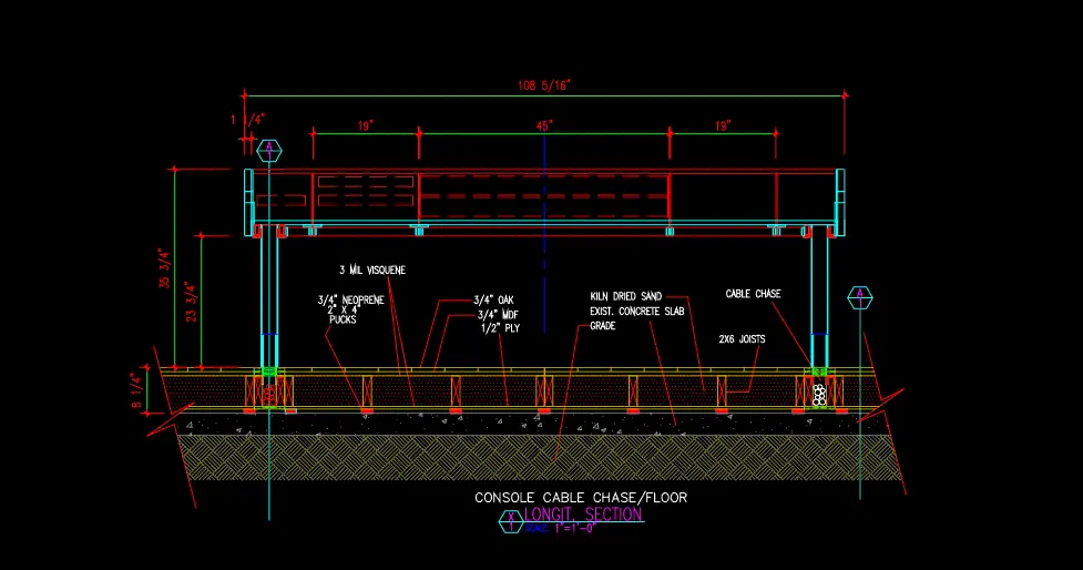

oh, heres a longitudinal section.
Hi Frederic, oh no, I welded this up long ago. This just bolts together with flat head socket screws. The legs bolt to the platform brackets at the bottom and the angle iron
brackets are welded to the legs, which bolt the frame in place from underneith. Everything else bolts to the frame. I'll start attatching that stuff tomorrow night. Hey, thanks for today. You made my day frederic! What a surprise it was:D And thanks for the cable answers. I didn't have time to get back to ya! Busy busy busy today. You know how that is, only two days on the weekend.

What are the dimensions of your side posts, the angled ones... they look like 3x6 or somethign there about, maybe 1/4" thick?
I really, really like how there are no legs in the way of human legs, a design I've been trying to figure out all along.
Want to be able to "wheel" left and right without hitting my legs on anything... furniture or cables.
You are one "Metal-Making-Magician" there Rick!
