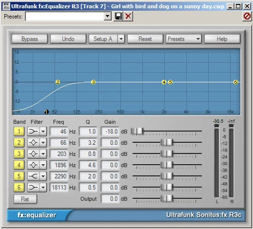

This is was posted by and is the work of Middleman:
HI PASS:

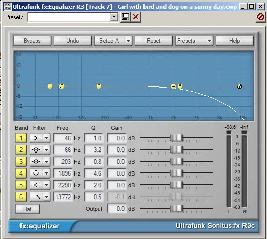

This was posted by and is the work of Middleman:
LOW PASS

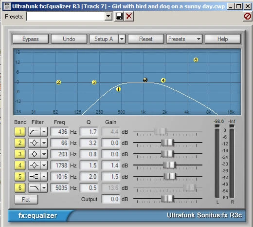

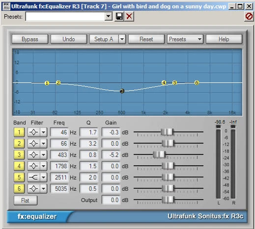

CUT

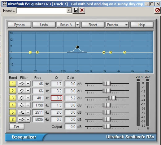

This was posted by and the work of Middleman:
BUMP WITH NARROW Q - ALSO A NOTCH

There might be a slight problem or mixup here... :)
To me a notch filter implies a cut, per the Rane definition:
http://www.rane.com/par-n.html
The post with the 'notch.jpg' looks like a bandpass filter to me.

The post with the 'Bump narrow q.jpg' looks like a bump using a peaking filter with a narrow Q to me but is labeled NOTCH.
