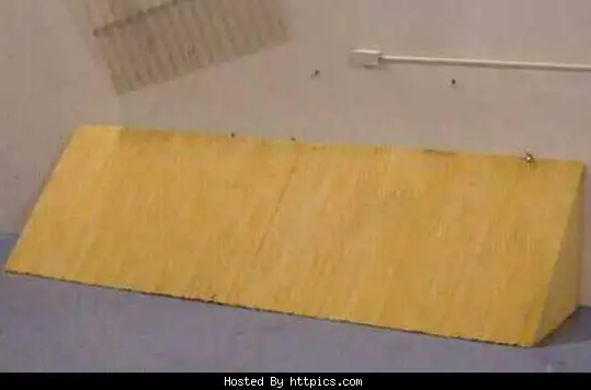

all 12 corners in a rectangular room are viable including where walls meet the floor.
Just to prove the point, here is a picture of a lab where they are testing a Superchunk, and it's at a floor/wall intersection..ie..corner. is.php?i=1234&img=Chunks.webp
note to author...attatching pics on this site is a lesson in frustration...ie..it may or may not show up
