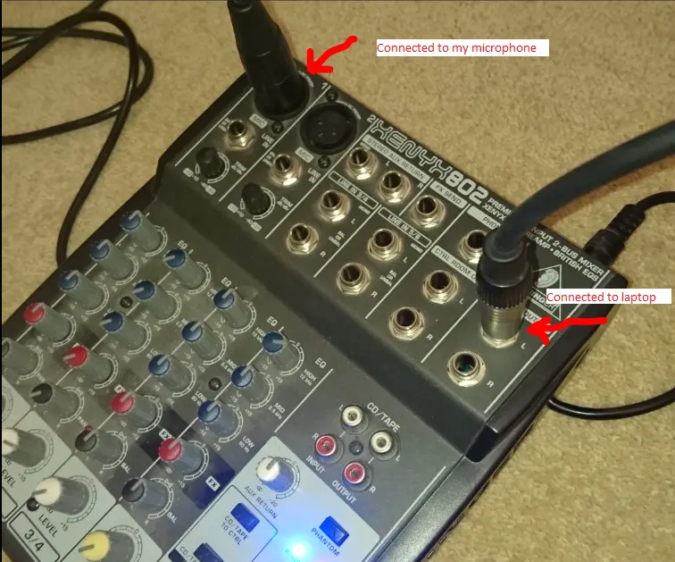

Hi guys,
So 8 years ago(ish) I got some recording equipment for Christmas just to put some music covers on YouTube. At some point I stopped using it but I've now pulled it out of a cupboard to play with again and, for whatever reason, I just can't get it to work.
The setup is super simple. I have a microphone connected to a Xenyx 802 mixer, which is connected via 1/4" Jack to a Macbook headphone port (via a 3.5mm adapter).
The microphone appears to be working (funky lights on the mixer whenever I speak into it) but the Macbook isn't registering any input devices beyond the internal microphone. Same issue with my Windows laptop.

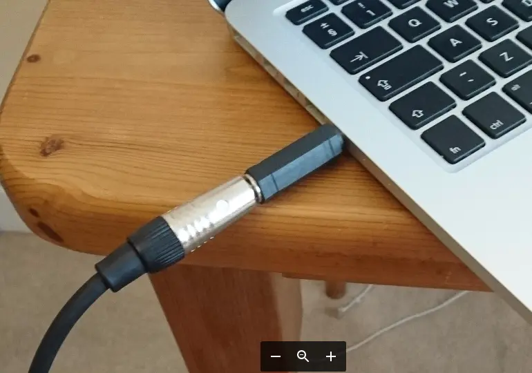

Hi there,
What kinda of cable and adapter are you using? Balanced or unbalanced?
The two look like this.
Doee the headphone output somehow double as a line input? If it does, there has to be some trick to telling that port to be an input instead of an output. (It could be as simple as plugging it in to the first lick)
It could also be a software issue, where you have to tell the computer to listen to that port, instead of the internal microphone.
I'm not too sure on how to check to be honest - on the mixer it is plugged into a dedicated out port as far as I can tell. The laptop doesn't list it as an input device so there's no option to tell it to care about that over the internal microphone.
Steenamaroo, the cable leading from the output port to the laptop appears to be unbalanced at both ends. The adapter is a 1/4" to 3.5mm one, but I don't know how to check to see if that one is unbalanced/balanced.
