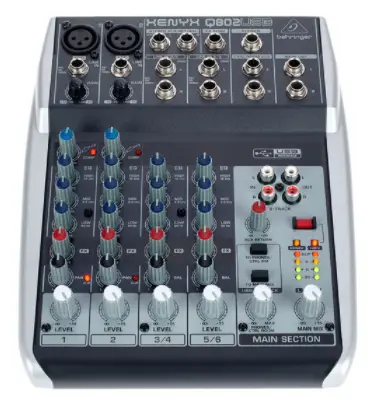

For a basic home setup, would I benefit from something like this Xenyx Q802USB, which to me looks like a mixer and interface combined?

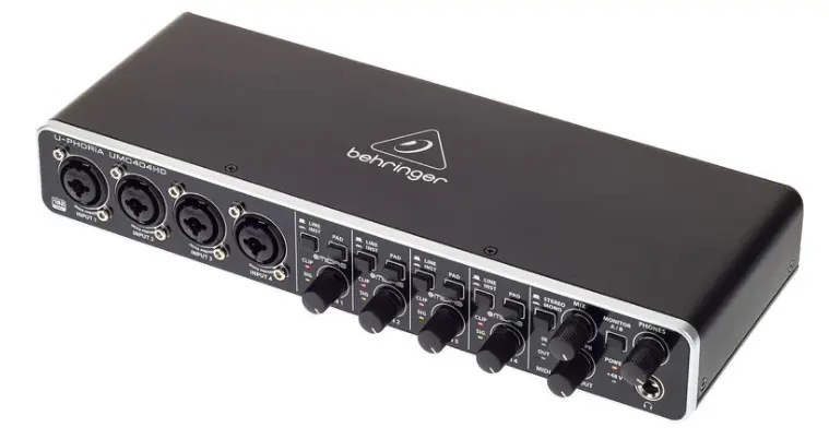

Or is something like this UMC404HD more appropriate?
Why would I choose one or the other? (Not necessarily these exact models, just want to know what is the difference between these two types)
Read this sticky thread: https://homerecording.com/bbs/threads/mixers-and-home-recording.338083/
Hi Amark and welcome to the forum. Yours is not a simple question so I shall break it down into chunks if you will allow and deal with each at a time.
1) Recording electric guitar 'directly' into a PC. Yes, best option is an interface and these are legion. The Behringer UMC series you show are in fact superb value for money. I bought my son in France the 204HD and he is very pleased with it recording classical guitar with capacitor mics and 'rock' guitar, tele, with an SM57 in front of a Peavey tranny amp. What he does NOT do however is use software guitar effects in real time to 'jam' with. The fly in that emolument is "Latency". This is the delay caused by several parts of the AI/CPU chain between you hitting a string and getting a sound out. Some folks can live and play with quite a lot of delay, others can bear little or none.
Budget interfaces are not likely to have low latency although in terms of sound quality they are very good. 0ne interface that does give very low latency at modest* cost is the Native Instruments KA6. I am sure many of the very latest generation of AIs also far better than they were in this respect but I have not tried them. People such as MOTU will be excellent but a little out of budget (Ggle "MOTU M4).

I have decided to go with the Behringer UMC404HD AI.
After hearing you all out I think it's the best fit for my needs.

That interface should serve you well. I assume the mic pre amps are the same as on my son's 204 and thus are really very good for such a low priced device. By "good" I mean they have enough gain for spoken word or picked guitar into a dynamic mic (though it needs to be pretty close) and low noise levels.
