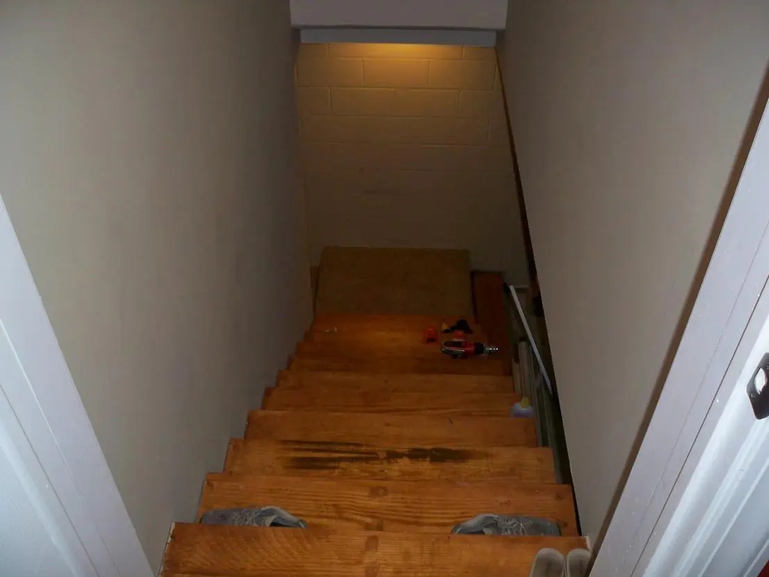

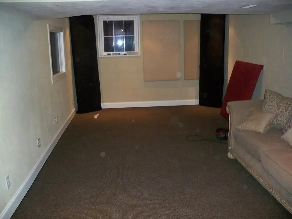

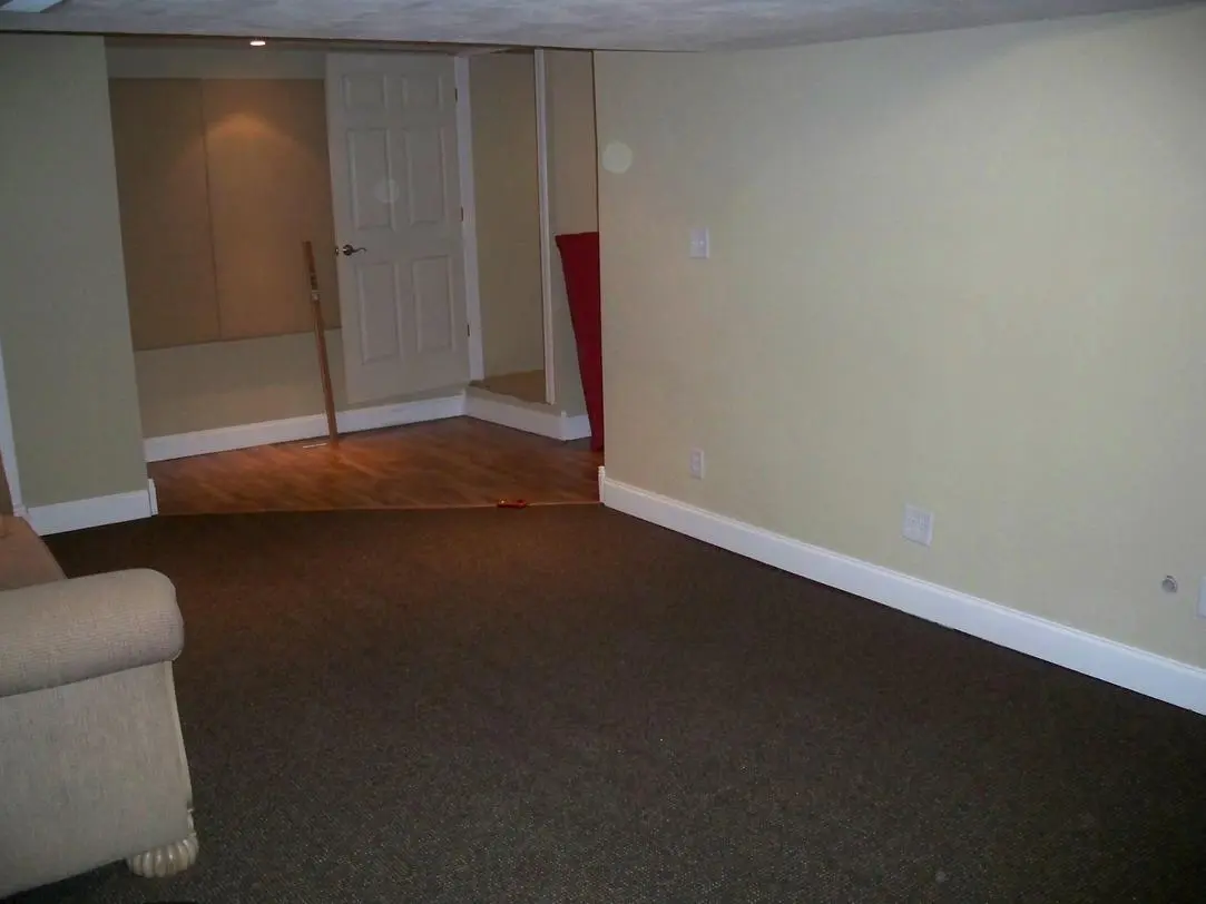

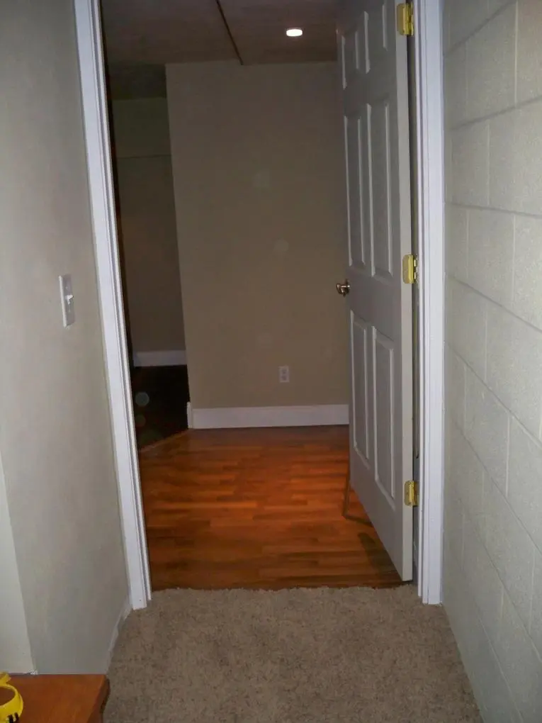

Well i'm putting up some treatment then moving in this weekend. Sorry my pics jump. I was busy and didn't have time follow through with pics. but here's wher i'm at now...

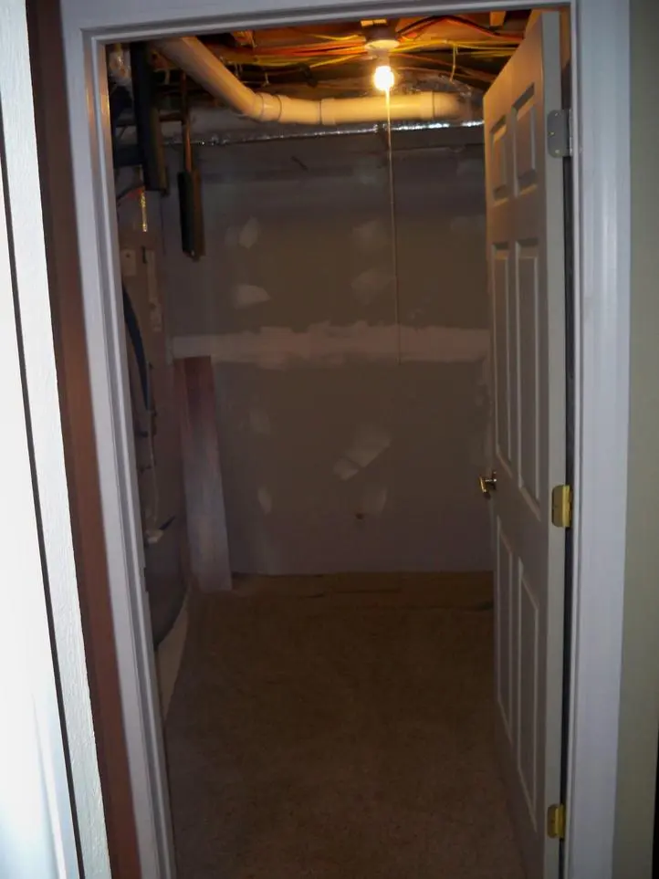

more pix
more pix for your pleasure

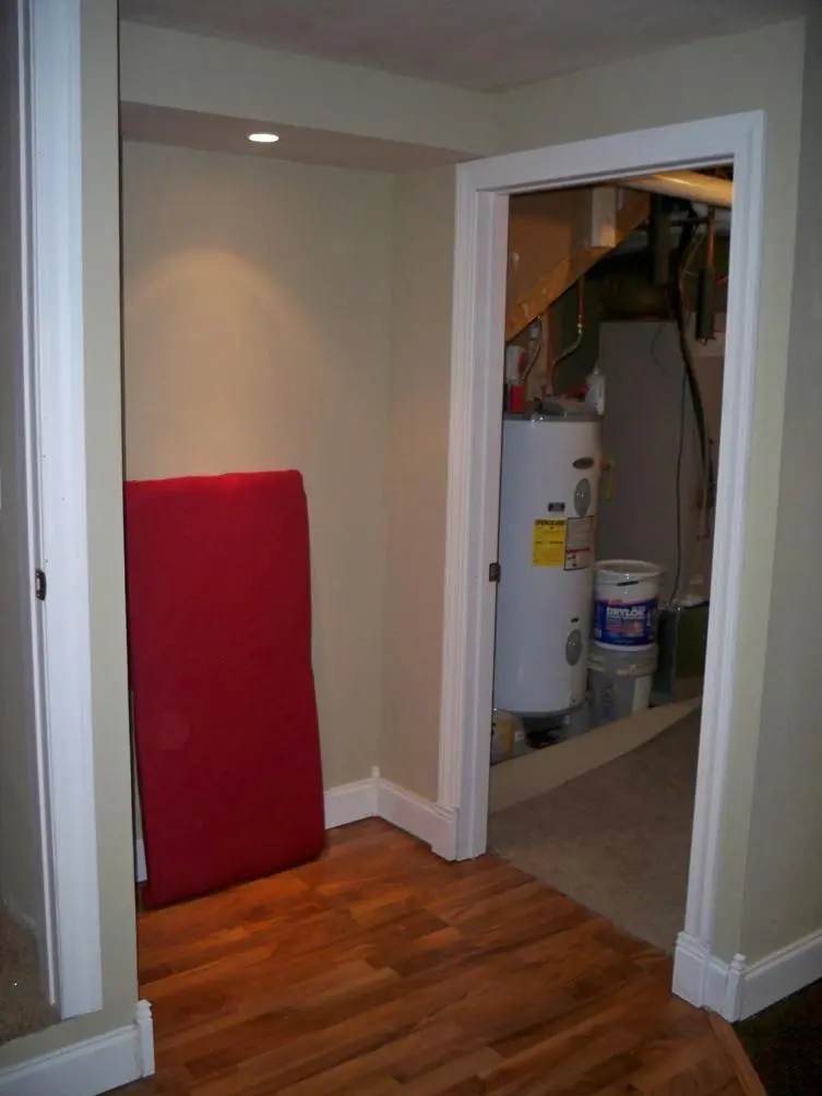

last one for now
last one for now

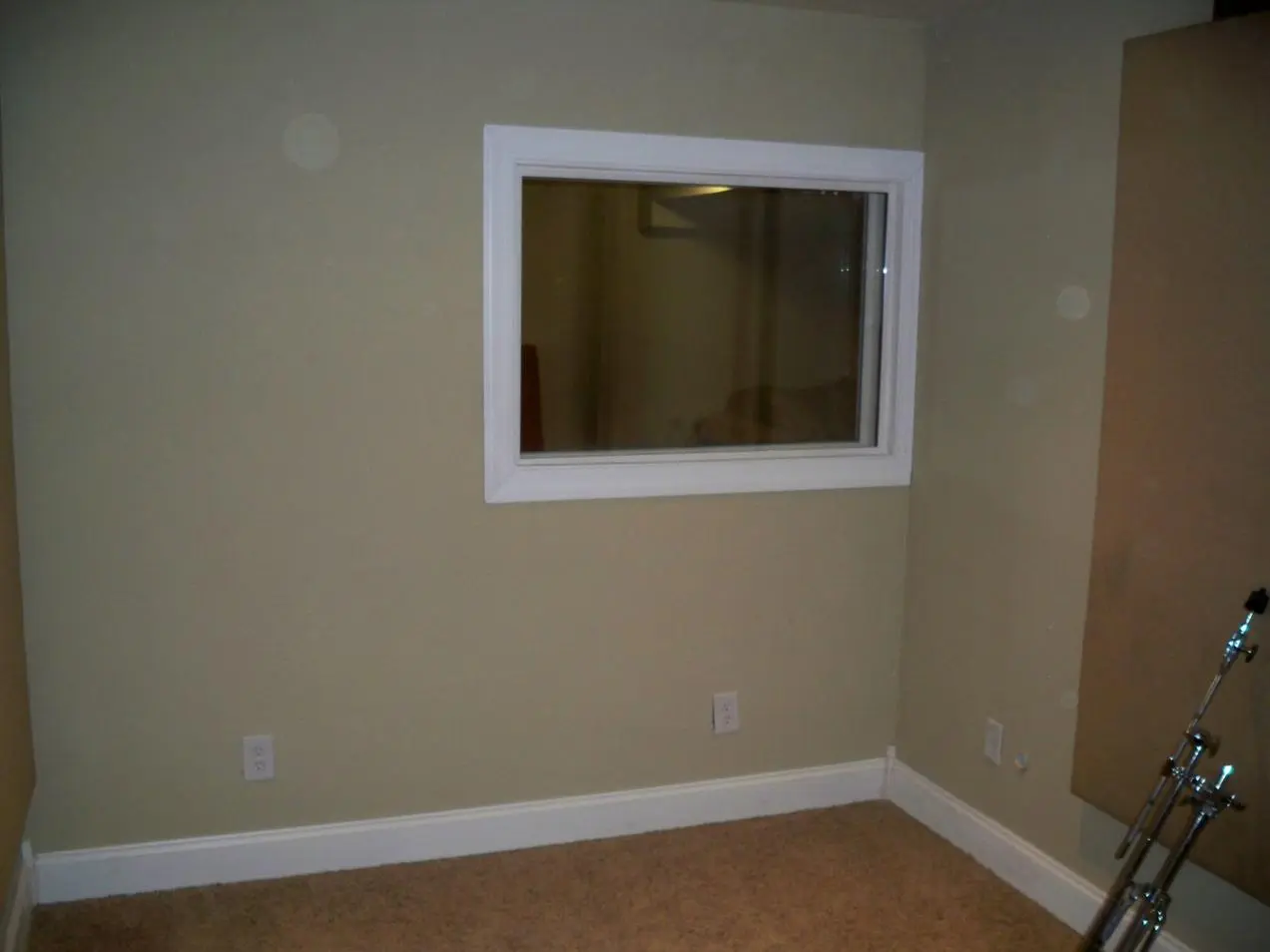

window
My window- i know alot of folks have questions about glass, so i thought i'd share. i have 2 sashes in there. both double pane gas filled. One pane is 1/8 the other is a 1/4. My father is a GM for a window MFG plant. This is what he suggested if the panes were the same he was afraid they would resonate. so really there are 4 panes of glass in there. one sash then a 3" gap then the other sash. each side sealed with culk. seems so far to be really effective, but hand clap and yelling still don't compare live drums...
