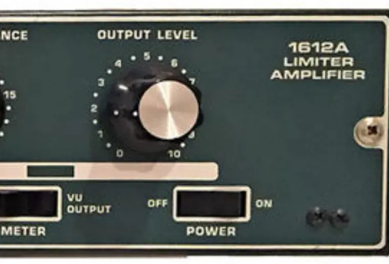

According to the manual, the output of a 1612A is variable from 0 to +27dBm which is pretty hefty! With a 600ohm impedance, that's about 25V.
Have you got a link to that manual Rich? I could not find one. Also should have said, OP should IMHO use the 150 Ohm winding.
I am obliged Rich. I still think the output will need to be attenuated because the meter is driven from the output circuit and so will be pretty useless if the compressor is operated at a lower than normal level?

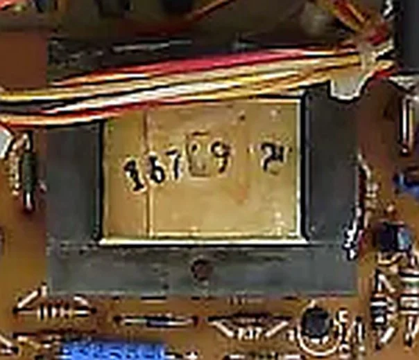

The resolution of that schematic is just not quite good enough for me to read the type number of that output amplifier. Anyone got younger, better minces?
It looks like it might be a Peerless 15769 or 16769. If you look at the transformer in the gut shot, it's stamped on the top. Schematic says 150 - 600 Ohm.
Thanks Rich but I meant the op amp that drives that transformer.
I didn't think I could find anything but I finallly found a discussion on Gearspace from 2017 showing it's an LM380 op amp. 2.5w audio amp IC.
