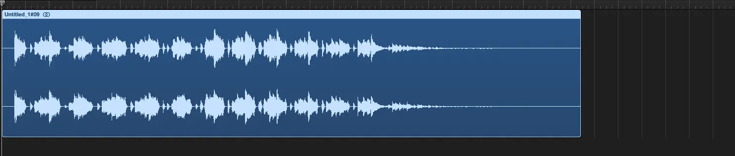

I think we did it guys. The new audio interface seems to produce the result I am pretty happy with :)

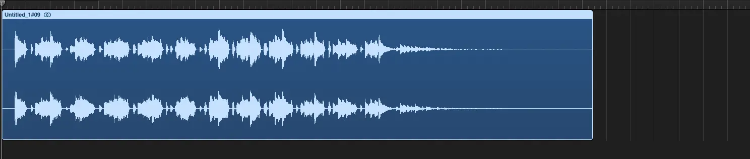

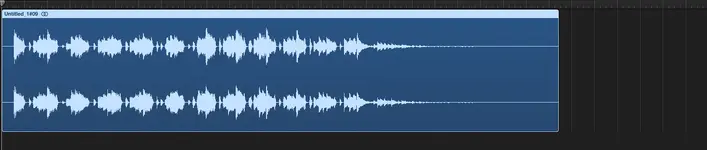

Just for reference, I will upload the before (when I first wrote this thread) and after (the one I just recorded now at different level outputs from keyboard, low level to high (making sure to not go over -5 and average -13 like someone on this thread said :D ))
Before: View attachment 101209
After: View attachment 101208
What do you guys think?
I guess there is still a LITTLE bit of that white noise even with the new Audio interface, but I would say it's a HUGE improvement from before. ..
Tensyume, the track with the new interface seems to have an improved noise level by a good ten db or more -that's significant!

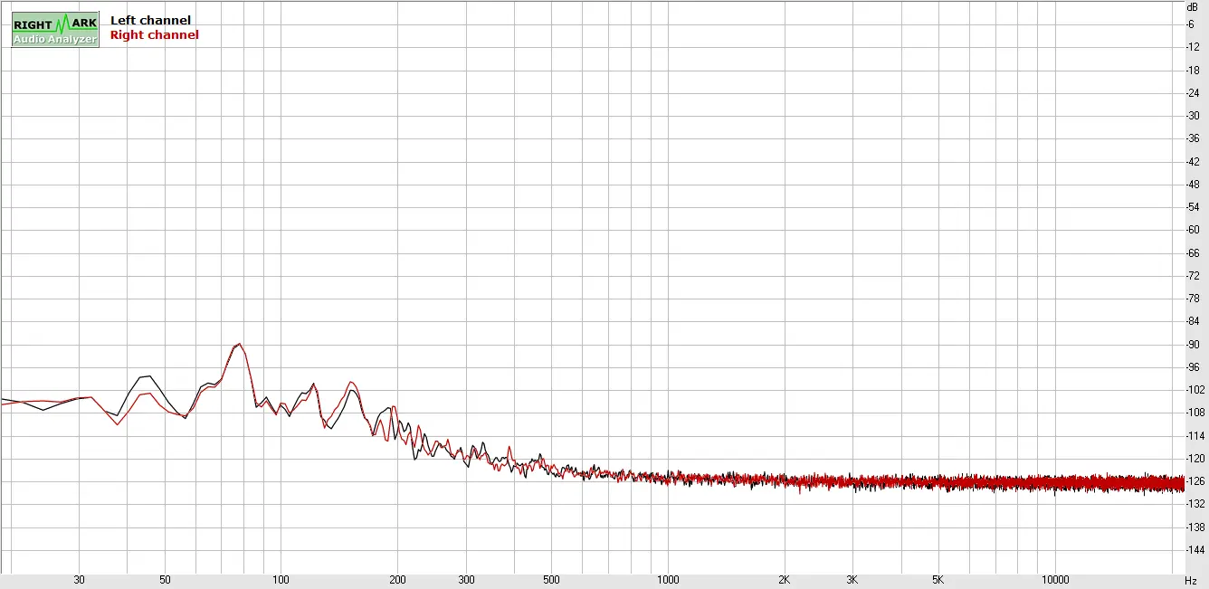

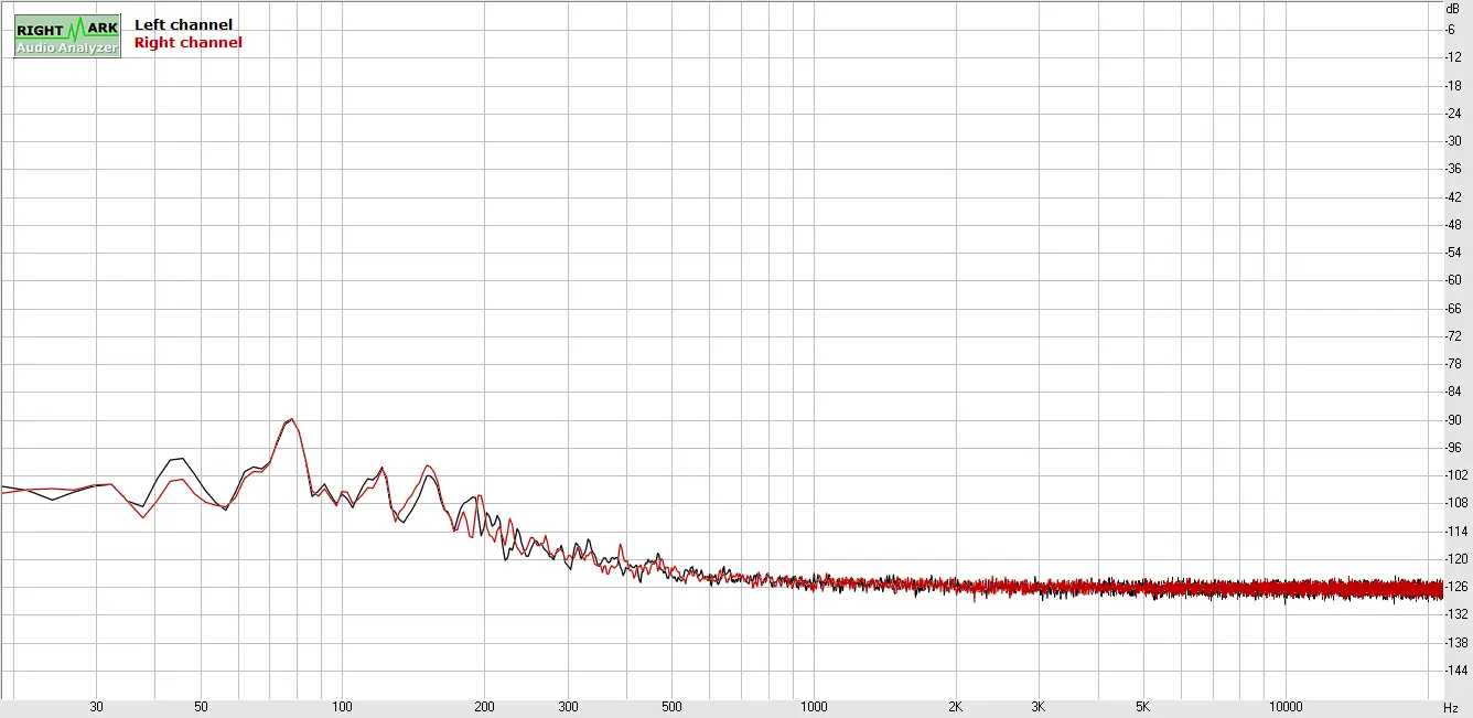

Much better!
The baseline noise is -76dBFS pk and that is probably as good as you will get. There is still something blipping up to -58dBF pk but that is still an acceptable S/N ratio.
Notable that there is a complete absence of power line artefact. These often show at 50/60Hz and 100/120Hz.
So, I think we got there? Newbs take note? When tracing noise we need SILENCE! (and a ref' level)

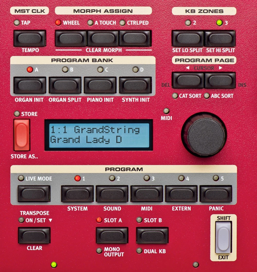

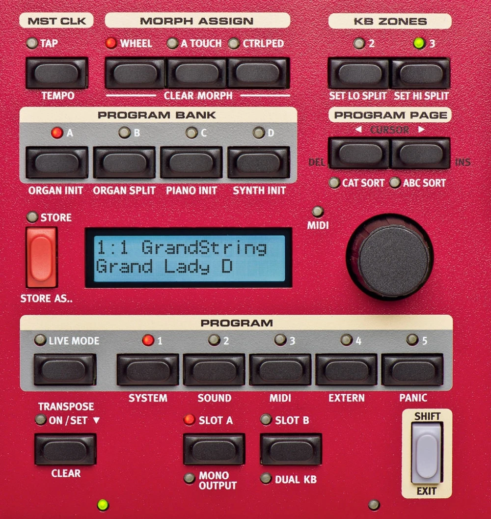

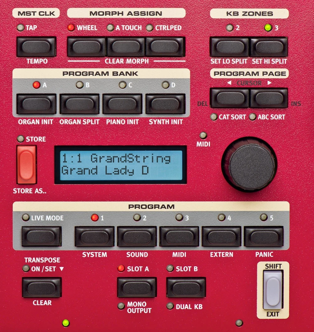

I hate to seem obtuse, but why are you recording a $3,000 piano through a $100 interface? It ain't gonna provide satisfactory results. Additionally, why bother recording in stereo? I'd suggest routing a single cable out of the Nord's channel 1, but be sure to switch the keyboard's output to mono (there's a physical switch). I guarantee you will get a better recording.
Hold down the Shift/Exit key and hit the Slot A button. The Mono Output indicator will light up.
