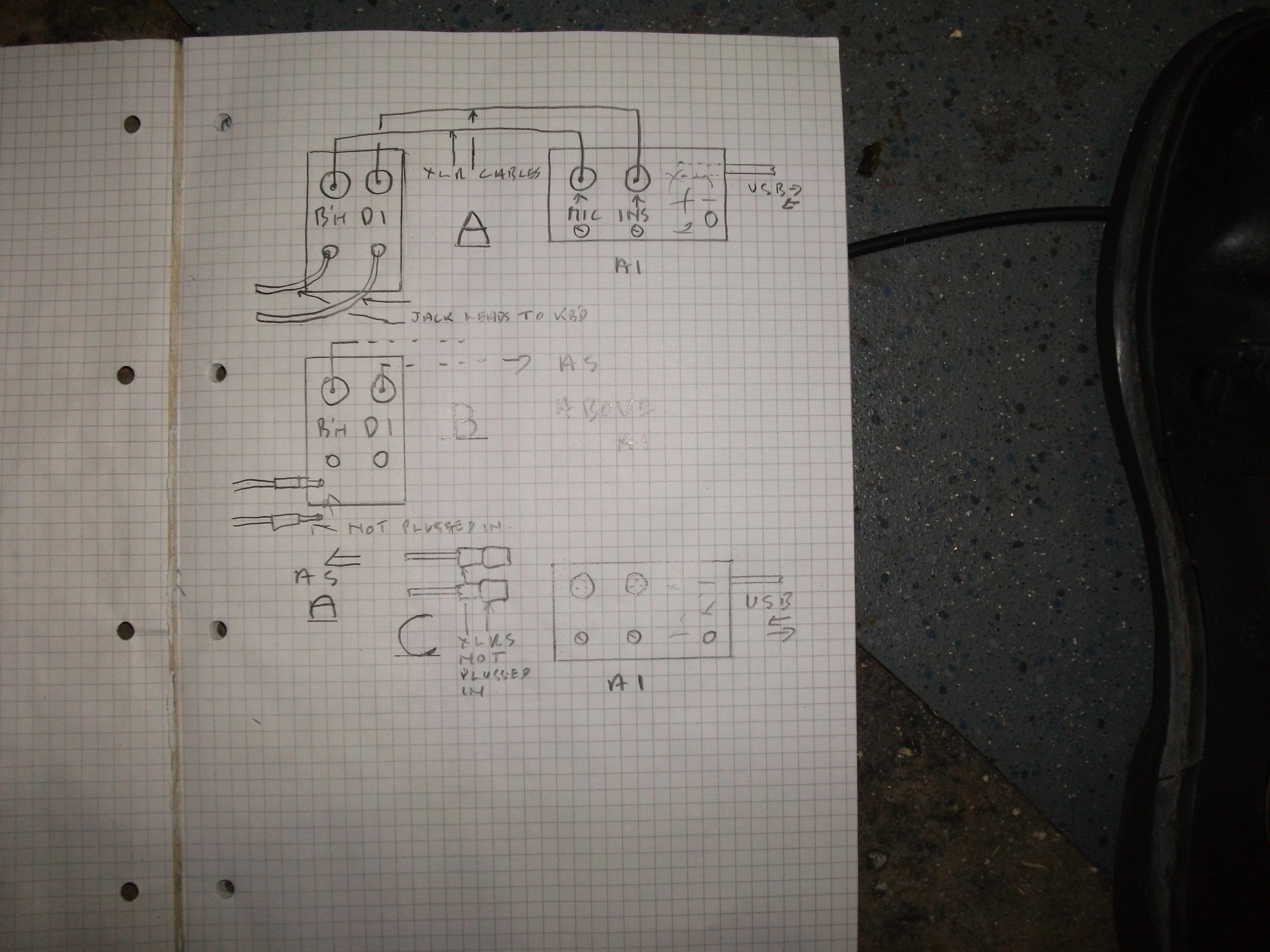

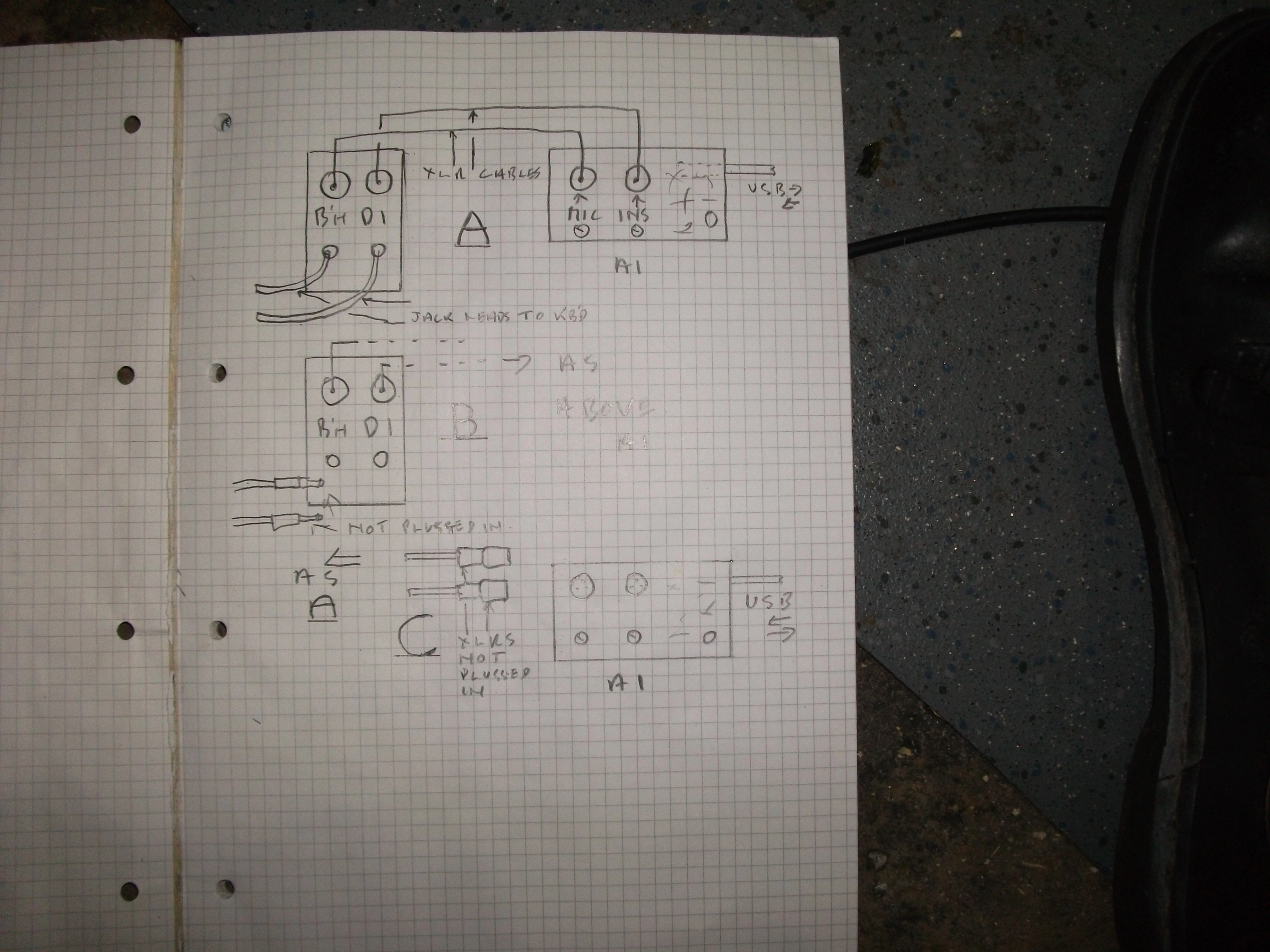

I have attached a drawing that I hope makes the noise test I outlined in #52. My apologies for the 'rough' picture. Not too well atmo and could not be arsed to sort out the scanner. My wee Fuji A180 was used instead.
I know it seems easy for ME to say but understanding the basics of audio electronics is really not that hard. Get a good grounding in Ohms Law then get to understand simple DC (lamp, battery, switch) circuits. The fact that audio signals are 'Alternating Current' really matters little in most instances.
