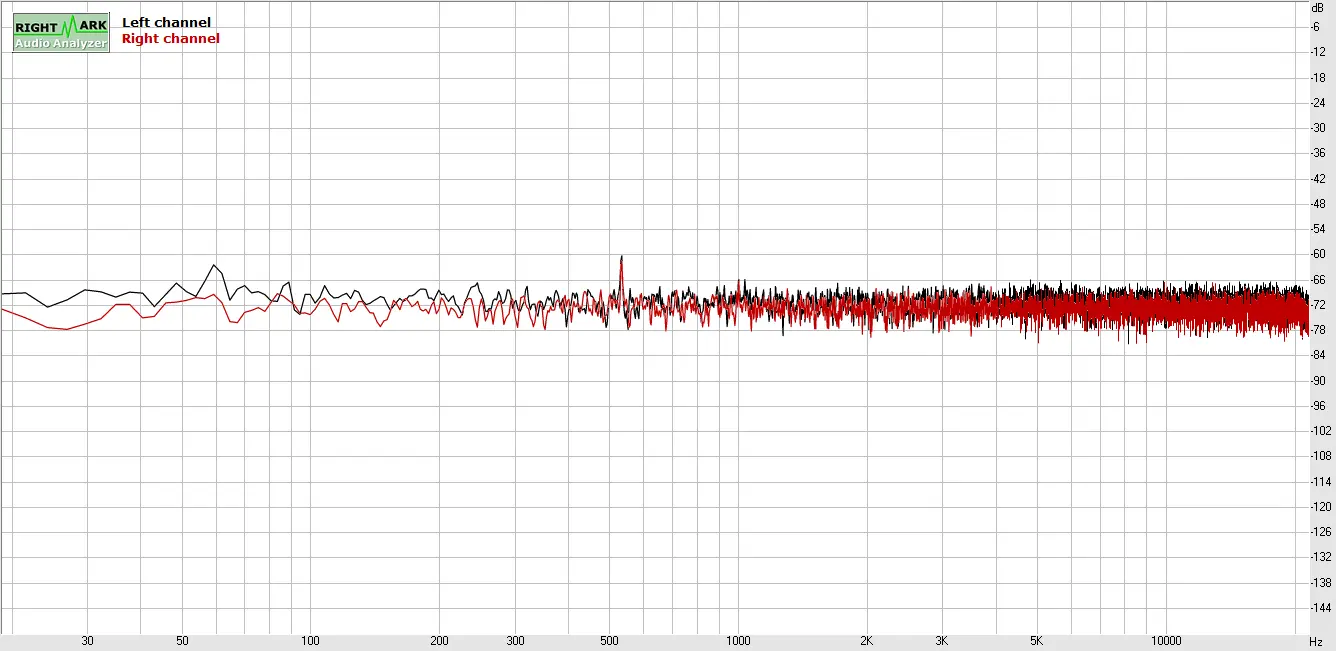

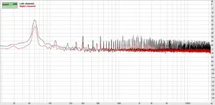

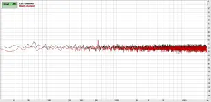

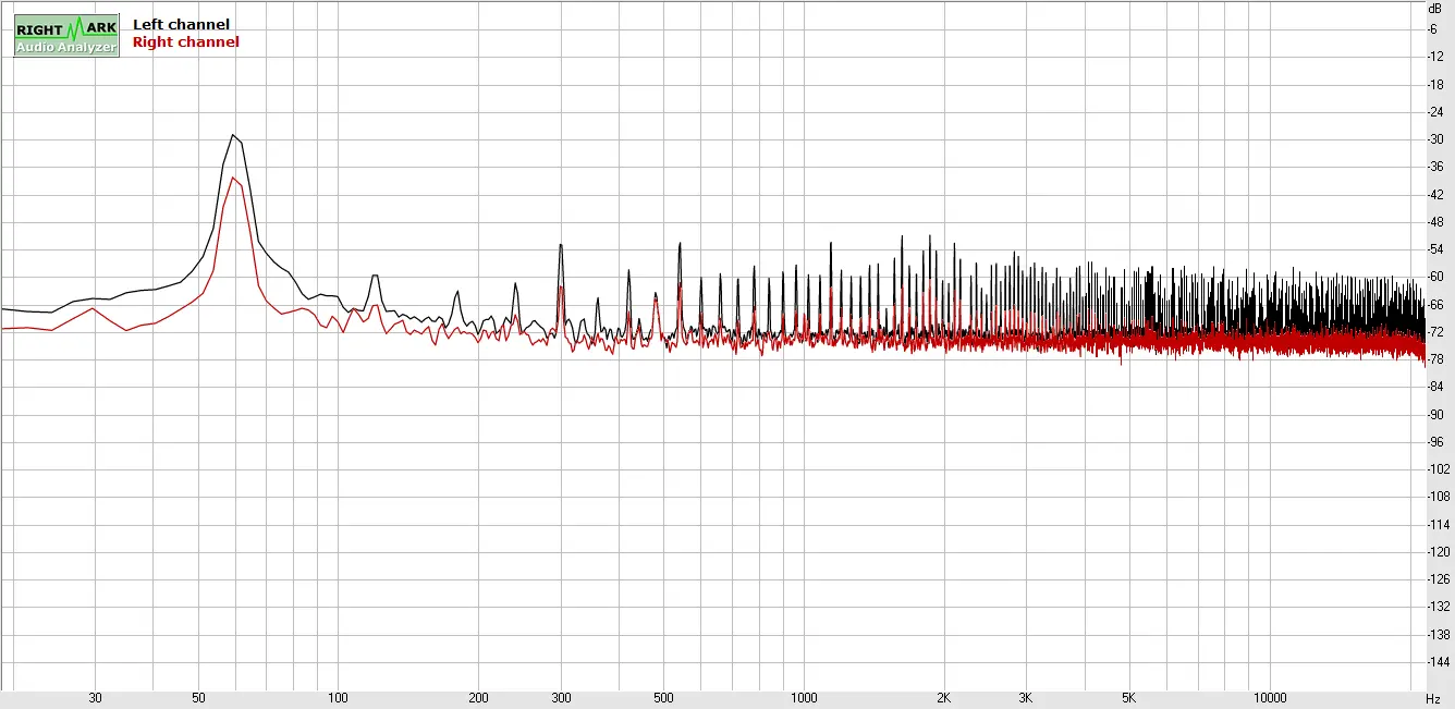

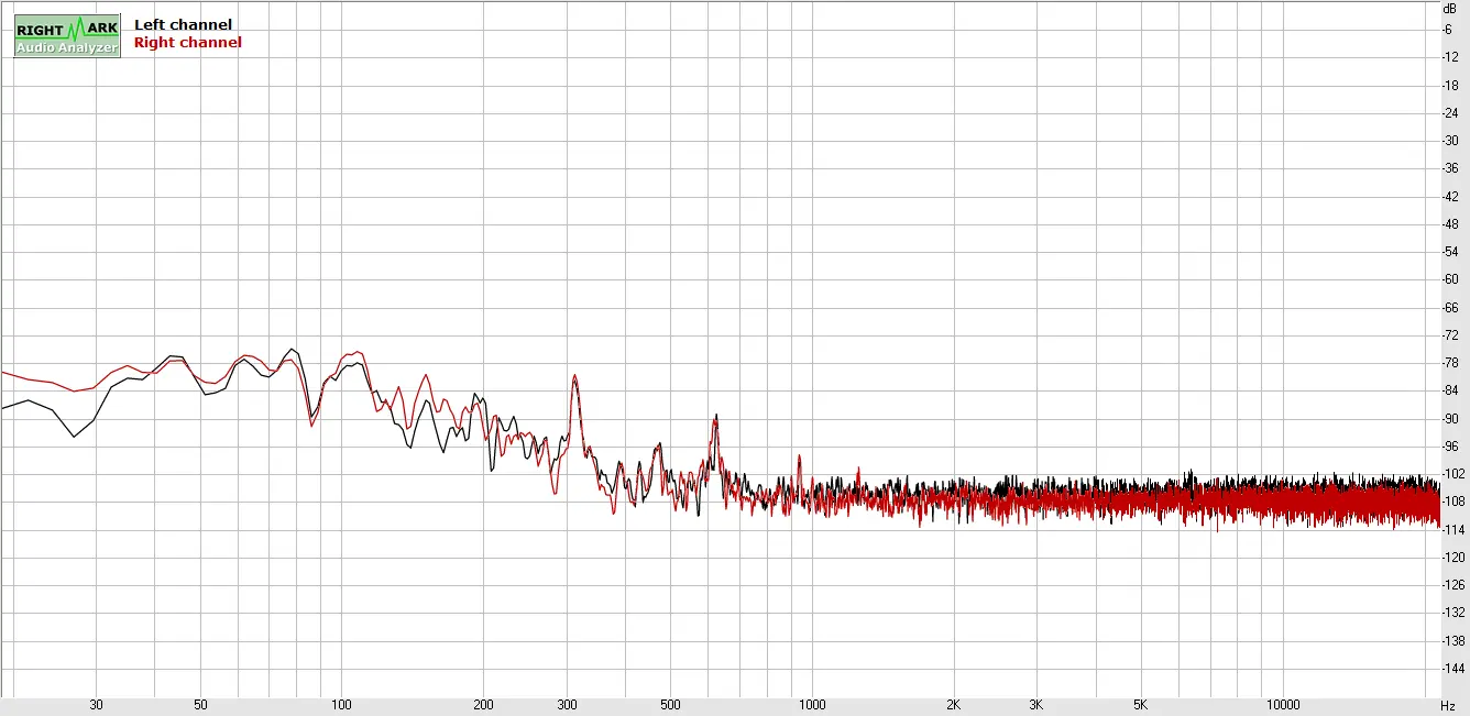

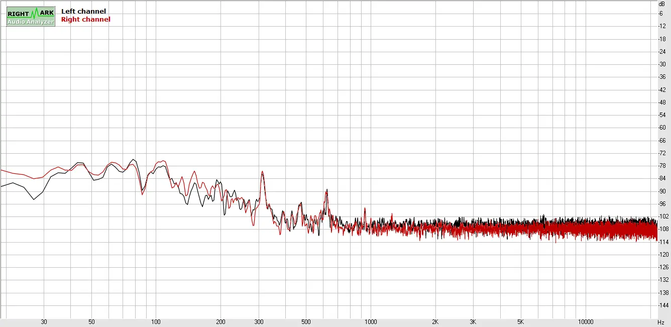

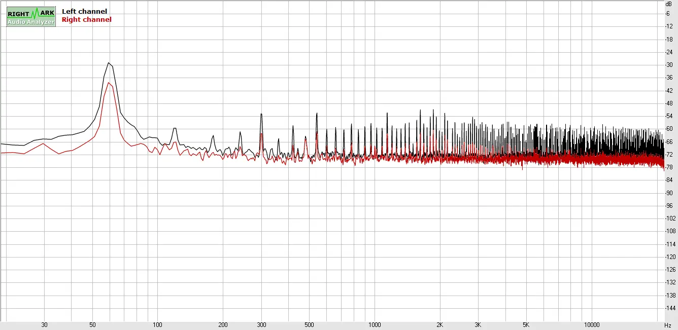

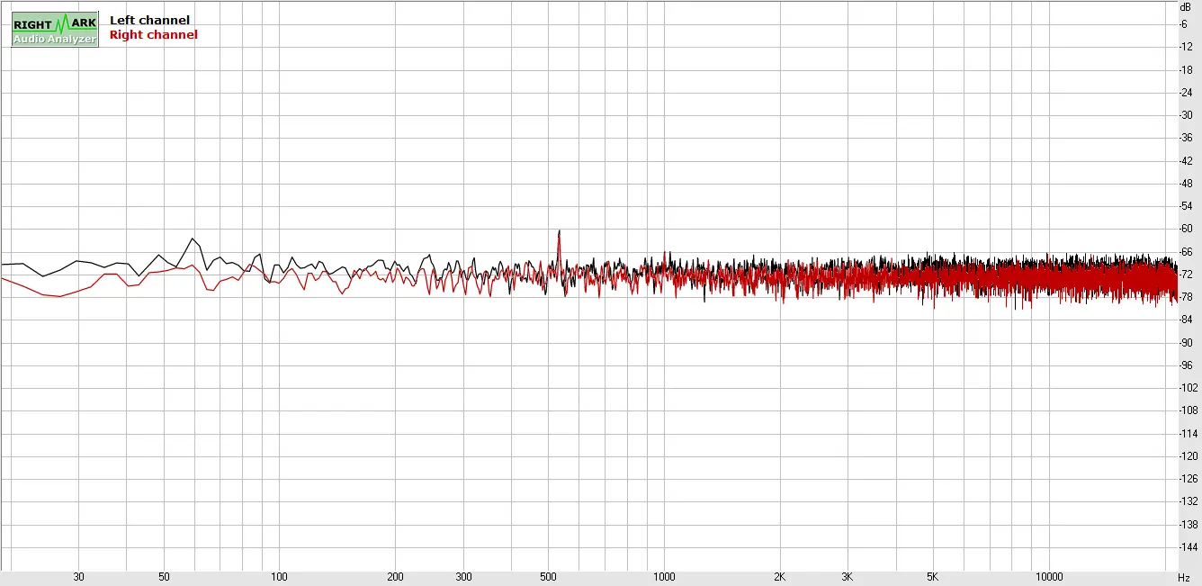

Attached are the spectra of the noise parts. There seems to be none of the artefacts you would associate with a 'ground' loop. Indeed the B awful result with the ground lifted* reinforces that there is none.
The next test is to prove where the noise is coming from (-46dBfs is a poor noise floor) . Setup the gear again, as before for the best result. Then just pull the JACK plugs out of the DI box. TOUCH NOTHING. Make a 30 second recording and post as MP3. Next, pull the XLRs out of the ABox and make another test recording.
Has to be said! That Berry DI has a reputation for being noisy. However, that is I think in the context of the much lower levels of a passive guitar, at line'ish levels it should be all right. Have you tried it on battery power and phantom off?
*Not sure how Behringer do that AND use phantom power? You need the screen for 0 volts. The MUCH worse result with the earth lifted causes me pause. You might not have the whole..PC, Kbd, AI, di-da EARTHED!

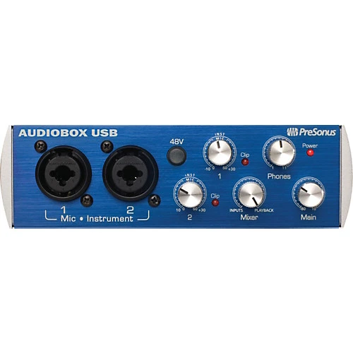

I have a setup where I have an audio interface (Presonus Audiobox USB) where I connect Left Out and Right Out of my Nord Piano 3 Keyboard to its Mic, Instrument Input (1,2 on the image below).

I am reading these thread comments (which I appreciate everyone's input by the way) and my lack of audio knowledge just hits the walls constantly. I am unsure what you guys would like to see me try. I did buy a new Audio Interface (100$ value) that actually has line inputs and was goign to try with that (it will probably arrive Monday, tomorrow). But if there is anything you guys want me to try, please let me know. I know [MENTION=89697]ecc83[/MENTION] asked me to record different configurations, but could you specify what "unplug JACK plugs" mean and by "pull XLRs out" did you mean pull them out while also the "JACK plugs" are plugged out? I also know you talked about everything being earthed, which I really didn't know what it meant (but i assume its something bad..?)
