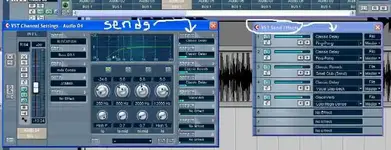

Here's a screenshot of how a send effect appears in SE:

To set up an FX track, you do it just like adding a group or audio track, which should then automatically, bring up a pop-up to select your fx-plugin of choice (If not manually enter plugin as an insert effect on the newly created FX Channel)). Then you can assign sends on the original tracks and control how much of each track goes through the FX Channel via each tracks send level.
Sounds like you have everything grouped together with reverb on the group track. Your reverb plugin is probably set to 100% wet/0% Dry (Hence the reason you only hear the reverb effected sound). Either set up an FX Channel (Prefered), or change the wet/dry ratio within your reverb plugin.
