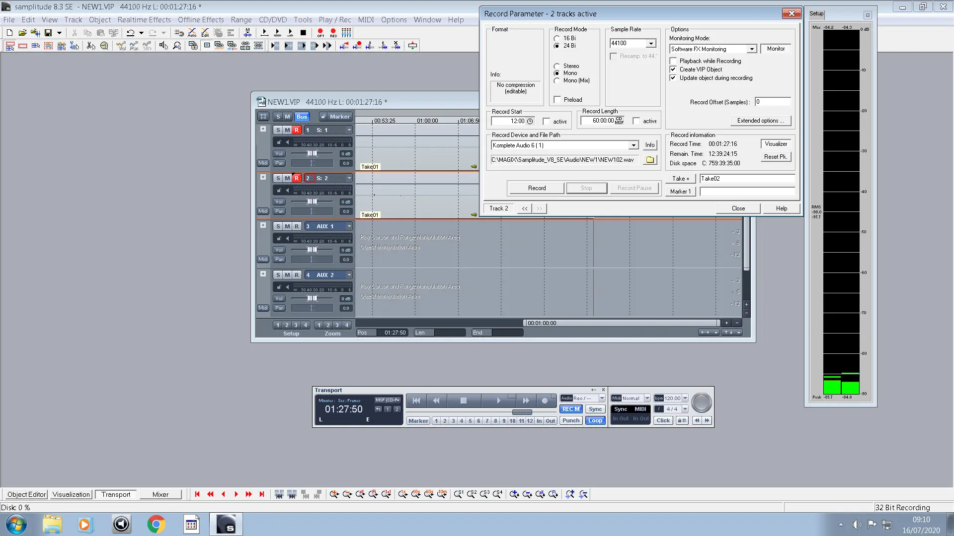

I set the first mic channel of the zed to '0' on the ch level, EQ flat but HPF in, pan central. The Mix Out pot was also at '0' I set the mic gain trim to get an average of -20dB fs with a Prodipe dynamic mic which is about 3dB hotter than a '57 (son has snaffled mine!)
The front levels of the KA6 were at 12 o'clock. I then removed the mic and replaced it with a screened 200 Ohm resistor. The noise level came out, as shown at about -97/98dB fs. (rms because the peak level jazzes about too much but is still around -88dB?)
These results I would aver are easily good enough for all but the most demanding work and WAAAY better than you will get with the (otherwise very useful) UCA222.
Note: I was using Samplitude SE8 (has meters down to neg 90) and set for two mono tracks. You can do that in any DAW AFAIK?
If you need more help/info? Shout! N.B. I still have a 2496 in that computer and very good it was too and like yourself, was fed from a mixer. Berry X802 then the A&H. The KA6 just beats it for noise, -102dB fs V -93dB fs and for latency, but the card was still bloody quick!
