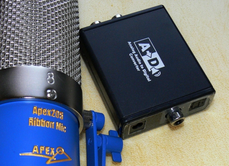

Well, one searches the interface along with a low output dynamic MIC to see what they can do. What they can do on 500mA USB power.
"Well, one searches the interface along with a low output dynamic MIC to see what they can do. What they can do on 500mA USB power. "
Not sure what you are saying there G? (Surprise! Surprise!) but if you are alluding to the 500mA power limit of USB 2.0 being a problem for AIs? Ain't so. Well, not a lot.

"Not sure what you are saying there G? (Surprise! Surprise!) but if you are alluding to the 500mA power limit of USB 2.0 being a problem for AIs? Ain't so. Well, not a lot".
Ya, I try to suggest the State of the Art Cheap does great for what it is - way, way back # 9. I'm not that impressed with the MIC sections in my interfaces. Now, mine are not the latest and greatest : ) After my post $9, I tried to count my MIC preamps from memory and I got to 100. Then I ran for a coffee refill and saw two more coming back from the kitchen. That's enough to make comparisons and discover what has merit.
You mentioned the noise and headroom, but kinda' forgot about the headroom. That's not just a level thing, but anything that requires current - like Moog Bass.
Now, we get the jack breakouts away from the Graphics Card, but computer power is still far from what what we should want for good audio, and, in my photo, there is a PIC of a MIC, a PIC of no preamp, and a PIC of the ADC section. You really don't want that digital section inside the cheap interface : ) Now my 13-watt ART DPS at least has the digital section tucked away in a corner on its own board.

They still do one way or another. I mentioned in some other thread my reference DVD/CD player lets me turn off power to the Digital out. No, its the MFG tossing out good Audio practice. "What they don't know, what hurt them"- type of deal. And we see that with the lack of meaningful specs
Actually, I buy the cheap small run Chinese digital to see what the state of the art (no caps) is;
"You mentioned the noise and headroom, but kinda' forgot about the headroom. That's not just a level thing, but anything that requires current - like Moog Bass." Smoog bass! The signal does not matter, a line output loaded with 10k Ohms or above (as it should be) will deliver the correct current, (that's naff all!) regardless of the instrument.
AND! You cannot divorce analogue from digital circuitry. EVERY a/d needs a carefully designed ANALOGUE amplifier (often an NEXXX) to drive it and an equally carefully designed ANALOGUE amp (Very often an NEXXX !) to extract the signal, often in 'current' form, from the D/A.
