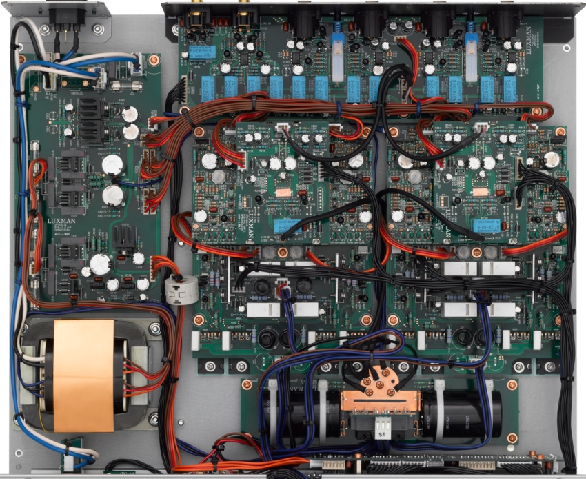

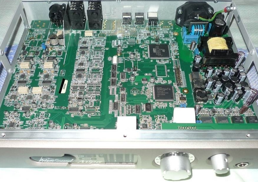

A pic of what a usb interface might require for circuitry, and the same with a headphone amp in the realm of surface mount..
Apogee thinks buss power is OK on the small stuff.

I just don't see the relevance of those pictures? You can make a very, very VERY good headphone amplifier with 2 stages of op amps and 4 complimentary high hfe transisitors and the whole thing would draw no more than 15mA per channel.
I am not knocking the high end stuff but it is on the limits of perception and 'diminishing returns'. There are many reasons people buy certain bits of gear, often not logically, the cache of The Valve (aka tube) is a case in point. Valve circuits are at least an order worse in most performance departments compared to even quite modest solid state gear but people still love them! And I am NOT talking about valve guitar amplifiers! They are a special case. There are several theories and explanations as to why valves work well with guitars and some of them even make technical sense!
Engineers hear the difference, alright. No qualms about pestering Dave Hill. Very few of the interface MFG have a very, VERY good headphone section - I suppose they may go to the expense, someday. Certainly, good enough for tracking, though
