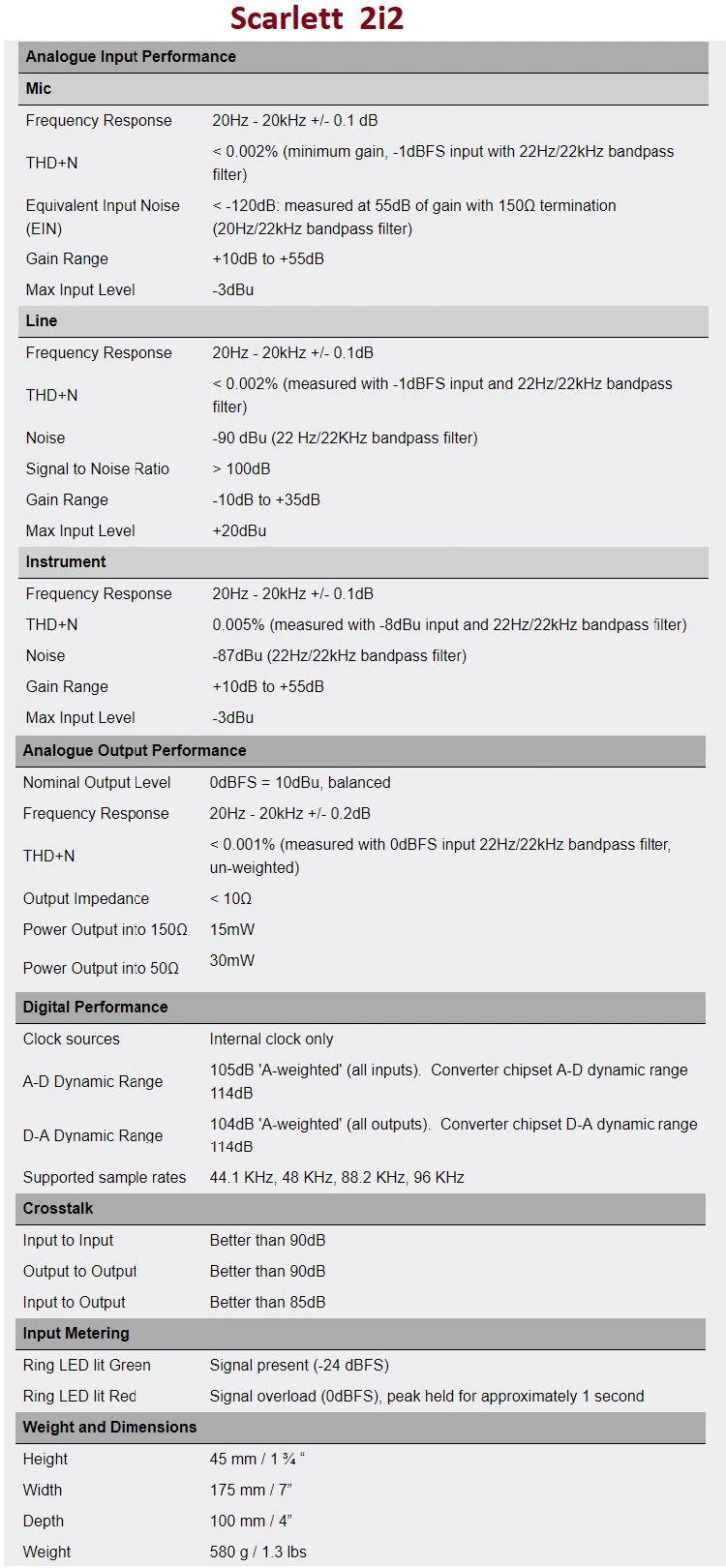

I see quite a few people in these parts using the Focusrite Scarlett 2i2 audio interface. Using this with Reaper, you could leave your Yamaha mixer out of the loop and use all the FX that come with Reaper - and there are a lot. It meets all your requirements.
The 2 outputs are for monitor speakers and shouldn't affect your headphone mix which comes from Reaper's mixer.

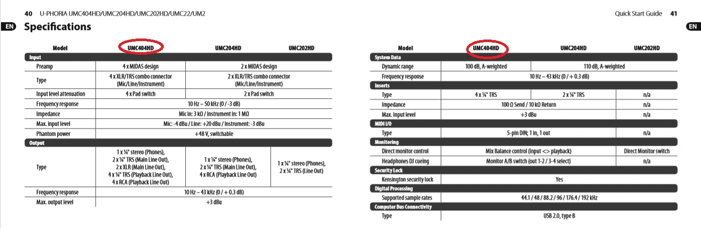

You will find your Nirvania with a U-phoria umc 404 hd for $100
Now that's a good price right there. I don't care who you are :p
Is there any noticable difference in the pre amps between the two mentioned? Mainly using to record female vocals.
Here's the specs :
I'm using the 2x2 if that's any help.
What pros / cons would you give with the 2x2? I assume you like it and would you choose it over the other ones mentioned again if you were shopping today for one?
Pros: Makes using a DAW (Reaper, in my case) extremely easy. Extremely low-noise.. super quiet. Plenty of headphone volume. Plenty of input gain for mics/instruments. 48V phantom power for mics that require it. MIDI in/out if you need it. All the cables I'm using fit snug into all receptacles - no loose or overly tight fitness problems.
Cons: Placement of headphone volume knob (2x2 model only). Squeezed between Line Out knob and headphone jack (when plugged in.. which is always).
I have to say up front I'm a fan of Tascam products, so I probably would buy the same unit today. Although, I would be tempted by the Behringer posted earlier by @TEC - especially as it's about $50 less and it offers 4 inputs vs 2.
With any of these, the hardest part is getting all the preferrences and driver settings set up on installation. It's not really difficult, but it can be confusing sometimes. Physical installation is easy - one USB cable to your PC (usually supplied) and an AC/DC wall plug adapter (also usually supplied).
Even though I had pretty much decided on mine, I still read tons of customer reviews just to see if any major problems jumped out. Every piece of gear gets it's share of 1 and 2-star reviews. Most of these units also get a high number of 5-star reviews. When you Google 'reviews [model #]', you should get plenty from all sources: Sweetwater, Amazon, Guitar Center, audio magazines, etc.

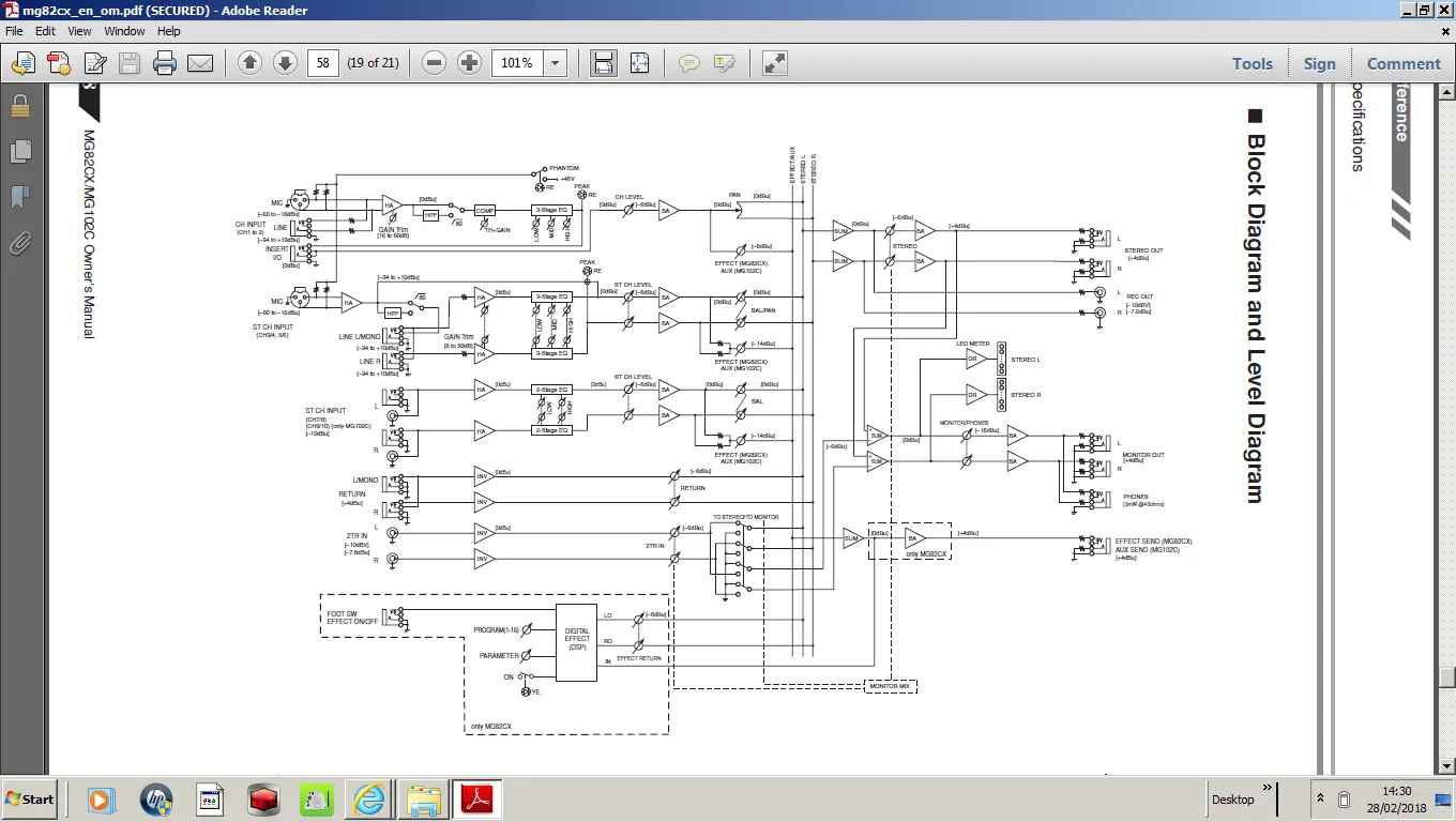

Just a quick question regarding using a mixer in the loop here. I understand when using just a mic and you adjust the gain to get good recording levels. When using a mixer in there with possible multiple gains and volume controls what is the best way to assure you are getting proper levels? I notice the mixer has some at 0db some at 4db and some still at 10db. I assume these are different levels as some will output hotter signals etc. Being new at this I am just curious on this. I usually just turn the levels until I get proper recording or sound levels but not sure if I am doing it the most efficient and sound quality way.
Yes, this 'gain staging' gets a lot of folks confused but in practice there is a pretty wide margin where you can operate with low noise and no risk of clipping.
The starting point is the DAWs meters and -18dBFS is the point you need to aim for. Set the channel pot and the MON out pot to their '0' or unity gain positions. This is indicated on the Yamaha mixer by an arrow at 3o'clock.
The MON outs feed the line inputs on the KA6. Waffle into a mic and set the GAIN of the mic channel until you get -18dFS 'ish on the DAW meters. The KA6 needs about -6dBu to deliver -18dBu to the DAW (WAKE UP at the back THERE!) which is about 400mV or not a lot. This will probably barely light the first LED on the mixer but then you don't want to refer to those LEDs anyway (it is possible to 'calibrate' the two devices so that mixer meter and DAW agree and I could show you how but not really needed) .
Of course. Circumstances alter cases and some recording jobs will require a bit more gain, others less but you still need to shoot for neg 18dBFS with peaks never higher than -6 and that would be really loud.

Thank you for that process. I was wondering what the triangles were for. Makes sense now.
Since you seem to know about the Yamaha a little... From my researching on the schematic it looks like there really is no way to use the ka6 preamp then insert to use the comp and ea and effects on the Yamaha. Am I correct on this? Not that I am trying to do that right now but just is now helping to better understand what I can and can't do by thinking of possible set ups.
Will have a varder. Bear with...
I think yes.
AFAICT say you want to put FX on an existing track, say track one?
Route that from say OP3 on the KA6 and feed to a line input on the Yammy. The signal can be sent via FX send pot to the FX section and the "effected" signal goes back onto the main stereo bus and comes out of Stereo outs. That goes to say input 4 on the KA6 and can be recorded.
This will all take a bit of plugging around and an amount of cuteness with the DAW's routing but remember, no matter how you plug things up or what crazy system you want to try you will not damage either mixer or the KA6.
(this is one reason I always tell peeps NOT to sell off wee mixers. ALWAYS handy as a headphone amp, talkback system, even a doorstop! You would get FA for it anyway. )
