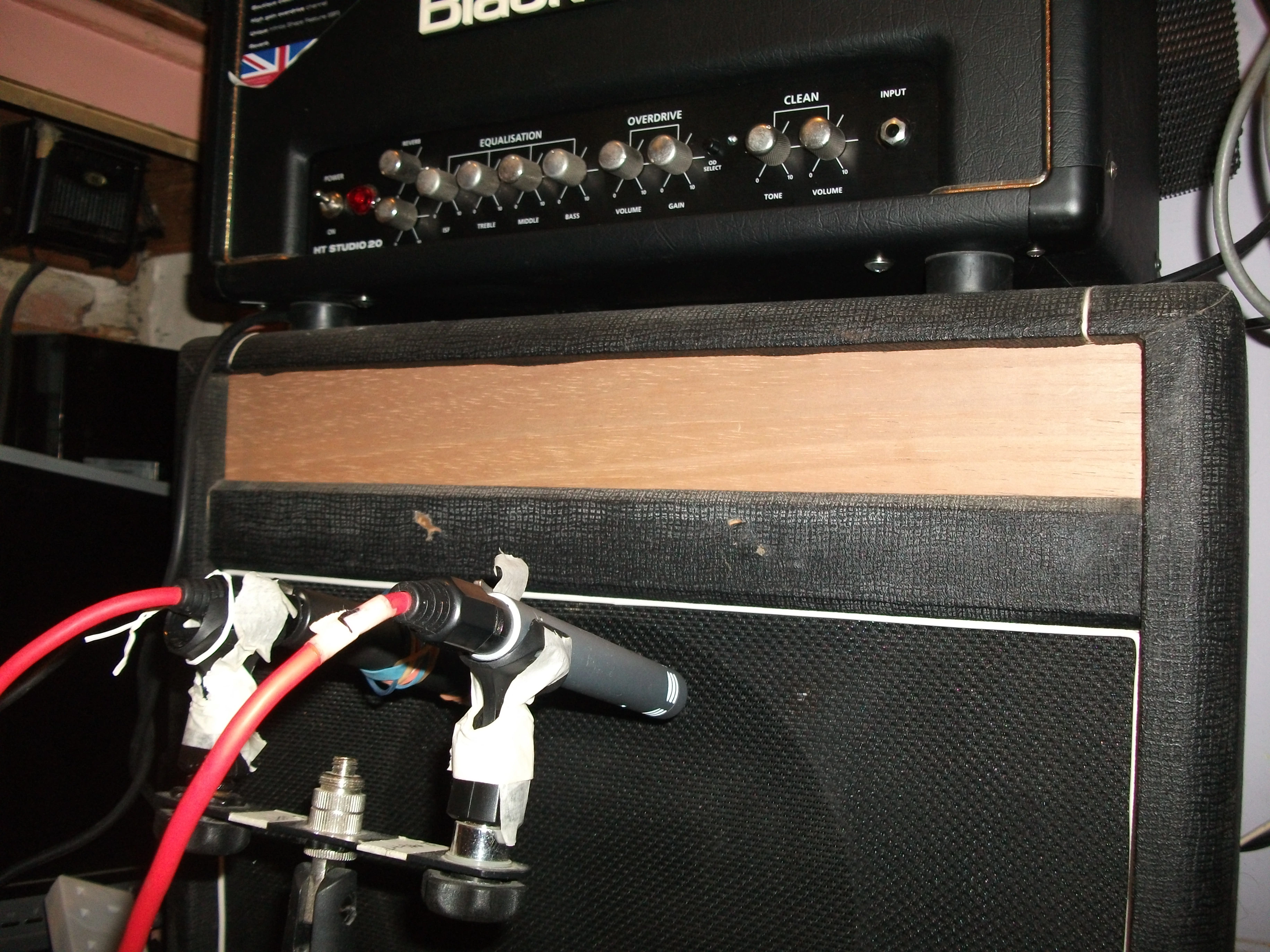

Attached are two clips recorded from my HT-20* on left, AKG P 150 (had to engage the -10dB pad to match the...)right, SM57. Mics into KA6** KA6 into home built Asus with 3.6G 6core AMD. DAW Samplitude SE8 (coz I can still drive that, a bit!)
The 57 was `10mm from the Celestion speaker fret, the P150 some 50mm, both mounted on a stereo bar so in the same plane, about equal about the cone centre (will do a smudge later) . Cheated a bit since although I HAVE the bits about to make a reamp rig I could not be arsed to find them and so played the clips out of my i3 HP laptop, battery power avoiding hum loops quite neatly I felt?
*Clean channel. Gain and tone were at max. Master volume adjusted to give a very rough 90dB SPL at my monitor position from the amp.
**Left ch gain at min (cap mic). This suggests that for some applications, i.e. very noisy amps and capacitor mics, it would be wise to invest in 10 and 20dB XLR pads for the KA?
Right gain, about 10 o'clock for the SM57.
The general levels in Sam 8 were around -20dBFS and peaks never greater than about -10dBFS. MP3s coded at 320kbps 44.1kHz. The original recordings were 16 bit 44.1kHz, I saw no benefit in 24 bits and it cuts out one stage of conversion?
.Wav to MP3 conversion was done in Adobe Audition 1.5.
Hope this helps?
Dave......Just run the clips back thru Tannoy 5As (via Asus) and I find the levels are different by several dBs. It is well known that people favour the louder sound in general so it might be wise to "normalize" the clips before coming to any momentous conclusions!
Piccy as promised.
The cab is an old wrecked out combo some one sent me, loaded as I said with the Celestion Greenback. I have several other speaker chassis including a V30 but son likes the more "jazz" tone of the Greeny.
I "intercepted" quite a few drive units on their way to a skip a couple of years ago. Two I am keen to try one day are a pair of Greenback 10 inchers.

Hi dave, good job and thank you for doing this. I think a small tone difference is still there. There's just something about the toneport recording that hits the spot for me. However, my intent is to run this through a high gain setup, and i think thats where I really see the difference.
What was your impression? And what did you think of the tones, live, before miking?
You are very welcome. There is a lot of gain in the 20's OD channel I will run the toneport track thru it the morrow. The reason I chose not to this time and used the clean channel is simply because if you aske 2 guitarist to comment on a distorted tone the answers will be "crap. Mine's better and crap"
My impressions? Ha! Way too deaf to call it. In any case I am not a player (can strip, mend the electrics and screen one for you..AND give it back tuned! But can only remember about 4 chord shapes) . Then, there are upwards of a dozen guys here that eat, sleep and ***t electric guitar. My opinion ain't worth buttons.
