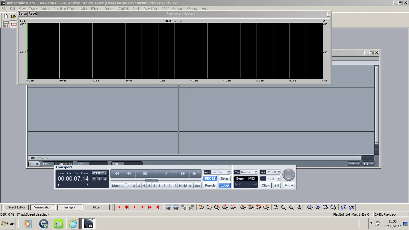

Noise: Rigged the KA6 into Audacity and recorded an 'empty' track. Noise was awful from previous experience until I realized everything was set for 16 bits!
The attached picture is of the Audacity .wav track played in Samplitude SE8 (for the meters) and you can see the noise floor for the KA6 inputs 1/2 is around -112dBFS (as I would expect of any 'DAW')
