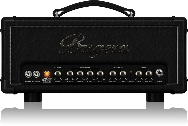

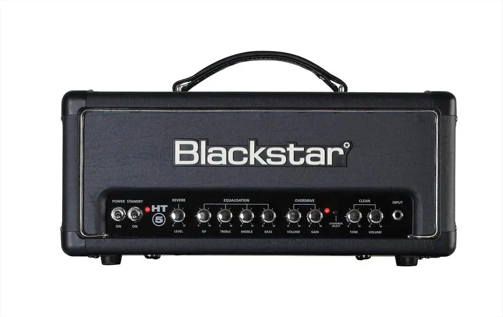

Some years ago a (conservative!) politician spoke of "The unacceptable face of Capitalism" I no longer remember who or what it was about but the phrase stuck.
IMO Behringer are one such face. The attached images show the amplifiers are not 'convergent design' (all valve gitamps are!) but a total copy by lazy bastards who don't want to, or do not have the talent to design their own equipment.
This 'wild west, free for all' idea of business has to stop sometime. The discussions are now beginning as to what 'industry' is for and for whom? The rise of rampant globalization, 'automation' and the depression of wages, zero hrs contracts etc has seem millions with no job and millions that have them still unable to earn a decent living. Nurse using FOOD BANKS FCS!
I said, "discussions started"? Interesting isn't it that now that technology and AI is moving into 'professional' jobs and affecting the chattering classes people are beginning to wake up!
