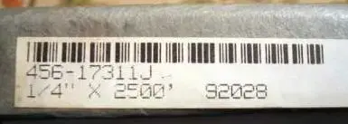

Check the date code on the side of the Ampex box or on the metal reel. This one was manufactured in 1992 (92028). What date is yours?

Yes, probably too old. Ampex 456 up to early 1994 is “Usually found in a state of sticky shed.”
The symptoms you describe are typical. The corrupted binder causes friction with the tape path, which slows down or stops the machine. The sticky shed build-up creates a barrier between the head and the tape, leading to low record/playback levels.
Clean the tape path really good with 99% alcohol or denatured alcohol before trying the Quantegy. All Quantegy branded 456 is good. All Ampex 1995 and newer is good.

Wah, I have 6 reels all dated 92. No wonder they were free...
