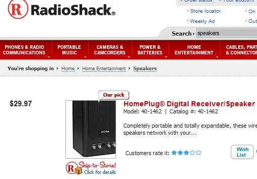

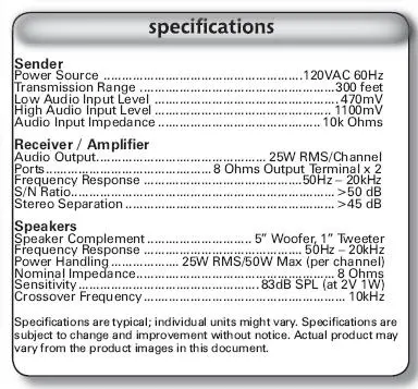

here's what I meant...with the spec statement.

here's the actual speaker this 50hz to 20khz spec belongs to....

let's use coolcat's specs from those ratshack speakers for an example. sure, that 50Hz-20khz is nice and all.....but what does the actual response curve look like?
we don't know.
are they +/- 1dB throughout that response? or are they +/- 35dB? do they have a flat response? or are there wild peaks and valleys randomly throughout the response? is there a rolloff in the low or high ends? if so, where? frequency response means nothing unless you've got a graph (or a +/- at minimum) to go with it. and even then, a graph doesn't really tell you a whole lot--hearing is believing.
the 4's don't even give a frequency response in the item description--that's a warning sign. the 3's do give one, which shows 100Hz as far as they go down. you have to assume that this likely after a rolloff (and probably a significant one), which i would expect to start somewhere around 400. the 3's do also give a spec of +/-3dB......but is that flat or peaky? and where do those +/- 3dB points actually live? is there a +3dB peak in the vocal range which will make all of my mixes vocal light? or is that a -3dB at 300 which will make me add a little to compensate and therefore end up with muddy mixes? i could go on, but i won't.
in short, those monitors are probably fine for playing computer games or watching multimedia content, but i wouldn't try to mix a damn thing on em.
