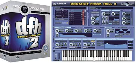

I've got another question about this app...I notice in the pic of the plug-in,it has 61 keys at the bottom of it...Do I need a 61 key MIDI board to use with this app?Or can I get along with a smaller(cheaper one)?
No, most midi drumsets only use about an octave and a half range. Most of the short keyboards can be mapped to this range.
You can actually just use the on screen keyboard if you like.
