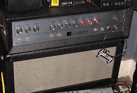

I've got an old GSS-100. Loud as heck, but no crunch at all.
