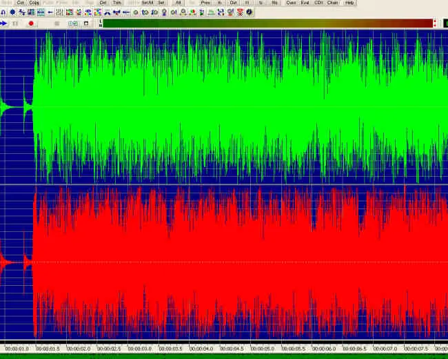

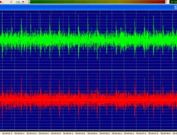

You're overloading like crazy. A little dynamic range is a good thing to have. Back off the master level and maybe there will be something to listen to. Below is a picture of the first few seconds of your mix. Notice all the chopped off waveforms at the top and bottom and the two red indicators on the far right of the L/R indicators. All of this indicates severe overloading.
The second waveform is a mix of the same song that I did and uploaded here: http://www.soundclick.com/bands/default.cfm?bandID=818206
I probably went to the other extreme in not compressing and making hot enough, but I think most would agree that it is better to go in that direction than in the overloaded and distorted direction.

Oops. Somehow the practice song got eliminated from my page (operator error on my part). It is now reposted. The image above is taken from the "Homeowner's Association" mix, not "Titanic Love", a song that I recorded for a customer in the late '70's or early '80's.
