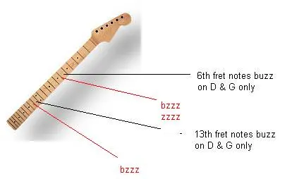

oh, yeah I got a wired fret buzz thing going on.
only 2 frets buzz, only two strings on those two frets buzz.
6&13 fret
D&G string
when I raise the string it gets better but the action sucks, when I lower the strings for the action it plays better but bzzzzzzzzzzzzzzzzzzzzz's....fret buzzing sucks.

Most likely a high fret one or more likely two frets up from where the fret buzzes. Lowering the high fret should not chase the problem down the neck, All frets should be the same hight. If you not happy dressing frets yourself take it to a decent repair guy, its not a big fix if thats all the problem is. Its highly unlikely to be a twisted neck.
damn I'm getting pumped up...thanks.
it just needs a tiny bit of lowering. I'll try this if I don't have to "chase it" down the neck!!
If I push really hard on the 6 & 13 fret, press down hard the buzz gets less too.
So I figure pressing down hard makes the angle deflection increase?
anyway...so good info.. I'll try it very gently taking the frets down...just in the middle where the D & G strings are.
yes 2 frets "up" the neck, not the one right bedside where the finger is...
but the next one by the "empty" fret?

Guys if it buzzes on just one string it HIGHLY UNLIKEY that it is a loose/popped fret. For a start for it to just buzz on the D and G it is going to have to pop up in the middle of the fingerboard, that just aint going to happen. Normally loose or popped frets are going to buzz on the top E and occasionally on the bottom E right up the neck. If you can see space under a fret in the centre it was like that out of the factory ninety nine times out of a hundred. If you do have a loose you need more than just tapping it back in to make it stay put. Most repair guys will wick in some titebond and clamp it down. In severe cases the fret needs to be removed and the tang opened up to help it seat correctly.
COOLCAT. Get a small perfectly straight edge and find the fret that is high in each case. as I said this is most likely to be the first or secound fret above the fret you are experiencing buzzing on. Have a good look at the fret and report back, whatever it is it's fixable. My experience would tell me that you have a couple of frets that were not dressed correctly when the guitar left the factory. I see hundreds of these setups each year on everything from low end Chinese imports to high end brands. Popped frets are very rare indeed these days because of the way the neck is put together.
used a small metal scale as the straight edge, which is the best I could find.
It wasn't easy to see a high fret, with the eyes looking for a gap?
What seemed to work easier was only concentrating on 2 or 3 frets at a time and sliding the metal ruler and then there was a high fret noticed when the scale would "bump" into it, stopping; The tiny corner of the metal scale would "bump/stop". Is this a common method?
it was such a small height difference, <.5mm.
the bumps were at the fret buzz locations...but i couldn't really check all of the frets until the "bump" is lowered?
Maybe some calipers would give some numbers?
ok, whats the secret... how does one remove that tiny of a bump with precision?

You need a small straight edge so your about right. I have loads of really small cabinet scrapers that are perfectly straight. A stanley blade is a good alternative.
For a start on how search "fret dressing"
Begin by reading this
whooa. ..after reading the thread, thats mainly dressing the entire f-board.
lets pretend only the higher fret is buzzing, 13th fret, D&G :p
(its the worst one.)
whats the best tool to just file it a tiny-bit to stop the bzz? Flat Diamond stone or the sandpaper.................. or??
i never realized the frets are flattened then curved/crowned, dressed.

The process for a single high fret even if your just taking off a bit under one string is the same. The advice I always give if your determined to do it yourself is to get hold of a few junkers and have a go on them first. If your only likely to do one guitar or a few a year, save yourself the time and get it done by a pro. The correct tools can cost as much as the repair and some.

You may have 2 high frets. It just needs fret levelling and a dressing.
