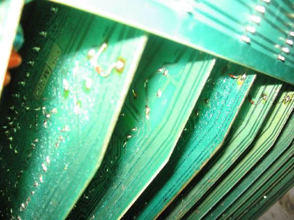

Okay I think I figured out the problem.
I was looking on the other side of the channel boards looking for anything that looked different and I noticed that something looked broken off. I believe it is a resistor that is missing. All the other channel boards have it except the problematic channel. I'll get a new one put on, and let you guys know if that solves me problem.

I'm talking to myself, but for whoever is interested:
See the resistors at the top of each channel board? The second board you see is channel 6, which has no resistor. The only part that bothers me, is that it looks like nothing was ever soldered onto that board. I looked where the resistor was supposed to be on the circuit board and it looks clean, like nothing was ever on there to be broken off. But surely if every single other channel has one in that spot, it must be the problem for this channel...
