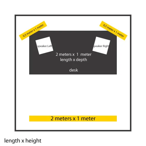

So to be sure...(European sizes)..please help :)..
Plywood - I think we call it Multiplex (picture attached...please help to confirm).
Sizes I need then:
3/4" = 18mm
1/4" = 6 mm or
1/8" = 3 mm
And depth of it should be 10 cm right? 4" I guess..or am I wrong on that?
And I use rockwool for fiberglass insulation.
Attached is also the "floorplan" which I have in mind and where to put the traps if I can make them correctly..please let me know if this is correct and if not..where it needs adjustment..
I thought I'd better post it in here then making another new thread cause there are allready tons of them.
Thanks!

The design with an airtrap and exposed sides is exactly what these are http://www.gikacoustics.com/ordernow.htm
I bought 4 of these are I am quite pleased with the results. You can walk into the corners and sides of the room where these hang and hear very little bass build up.
Price is right too.
